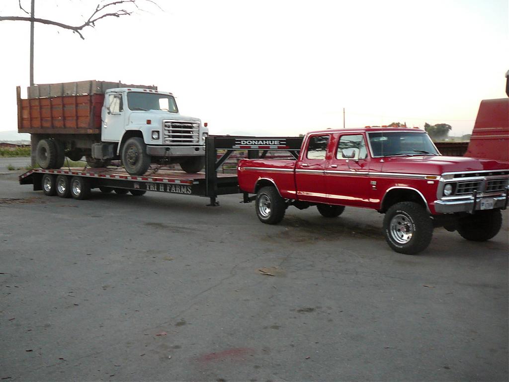

i like to see towing pics,so thought i would post. ve pump tows very well set up right. my injectors are 5x13 or 5x14, not sure wich,get them used. flow more than 5x12,s and pods. trailer wt is 6000lbs, truck is 11000lbs. ive towed more but not often. most of my towing is in mountains, 4800 ft to about 8000. towed as hi as 10,000 ft. this trip was pretty flat. in 5th on a slight grade passing a car egts got about to 1200. i rotate my fuel pin(cone) to shallower side when towing heavy. dynoed at 331 with this setting. on acceleration egts arent a problem. he-351 tows well. i used to ron pods and an hx. worked well too. these stixs run a little hotter than pods. i usually only tow 6000 to 8000 lbs. a load this size is no problem on the flat but in the hills i drop to 4th, keep rpms up its ok. if i worked it in hills this heavy all the time i would go smaller on injectors. 06 intercooler helps alot too. i think afc tuning helps alot when towing with big stixs. or a valet switch.

very nice lookin truck an love to see the older trucks look like new

Looks nice man

looks and sounds good man, I love your truck more and more everytime i see it or a pic of it.

crewcabxlt your ride is sharp. I like the 3 axle gooseneck, I miss mine with the smooth ride of the 3 axles. The 3rd axle sure takes alot of the jar outta the ride on rough roads. Fantastic looking set up and good job on the thread of keeping us informed on what's working good on pulling.

thanks, the gooseneck is nice , 30ft, 3 axle really pulls smooth. my dad actually owns it. one of the benefits of working for him on the farm. 1bad93- i used to run an hx-35 and pods w/ a ground fuel pin. i would rotate my pin to shallow side for towing heavy. i made several trips to salt lake area with this set-up to haul home wrecked or broken trucks home. pulling a heavy bumper pull w/truck on wieght of around 8000 to 9000 lbs. 200 mile round trip. about 8 miles of 5-6% grade to climb each way , 4600-6200 ft elevation. on the freeway at 70 -75 flat cruising egts around 700*. uphill on the climb in direct,(4th) at 60-65 egts ran around 1000,boost around 30 psi. uphill in 5th pushing 65-70 egts climb to 1200 and i have to be light on the throttle.to my surprise i consistanly got 18-19 mpg on these trips. now w/he-351 , bigger stixs and a slightly ground afc foot i do about the same,need more time to tell. i have more power too. i think the he-351 matched with pods or a smaller injector would tow really well. PLEASE NOTE: this is my experience with my set-up, i have done alot of small details to help cool egts. AND i am a guage watcher. please dont melt any parts on your own truck. the afc tuning seemed to really help control egts.
