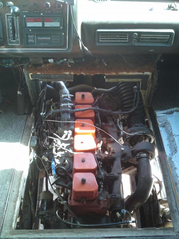

I haven't seen your setup, but in my van I used an 03 exhaust manifold so that my turbo was tucked into the block, I had to move the transmission cooler, but it made all the difference on room.
(also exhaust wrap makes a big difference for spool up and under hood temps)

03 exhaust manifold . . . Great info, I'll have to look into it. I have a huge alternator (Delco 28SI), how's your intake air duct fit over the alternator with the manifold mod? Here's an old/outdated photo.

Getting rid of the accordian style intake hose for a mendrel bent pipe may help slightly as well.
