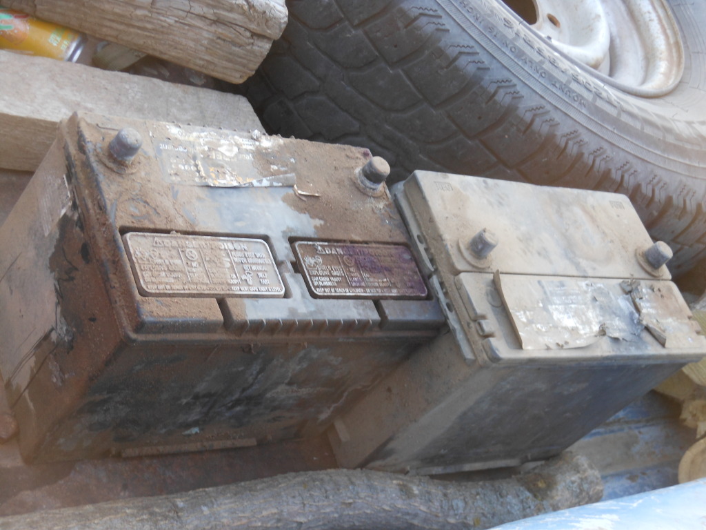

The old ones. One was a no-name, the other is a Wally's-mart special, I'll let you guess which is which.

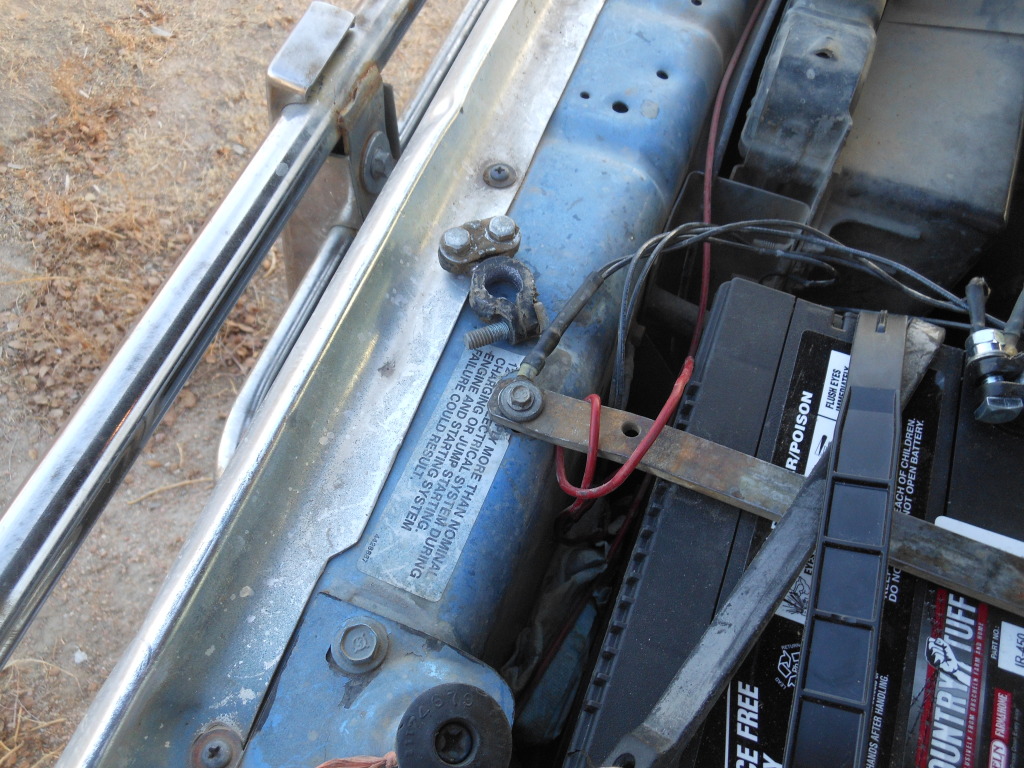

Guess what I found when I got home, rode there over 30 miles.

These weren't $8, I know that. Had to buy the bolts separate for the fancy nuts for them, but I don't have to worry about trying to get a wrench on them. That was another 80 cents. Cleaned up all the posts and terminals and scraped where the cables clamp into the new terminals. The other two that the cables bolt to were in the truck when I got it.
Group 31's around here are $110+.
This way if one goes bad, I can still run on the other one for a week or two like I just did this time. If the battery had gone bad in the spring I still would have waited to replace them.
There were several layers of thick cork gasket material under the wally's-mart battery to get up to the same height as the no-name. The terminals won't be hitting the fender now, either. It was a problem with the wally's-mart battery. They are all labeled group 24 but it is a half inch shorter than the other three. I layed them out so both batteries are sitting on two layers of cork.
If it weren't for a bracket of some sort between the battery and radiator I could have dropped in a pair of group 27's but they are at least another $60 for the pair.

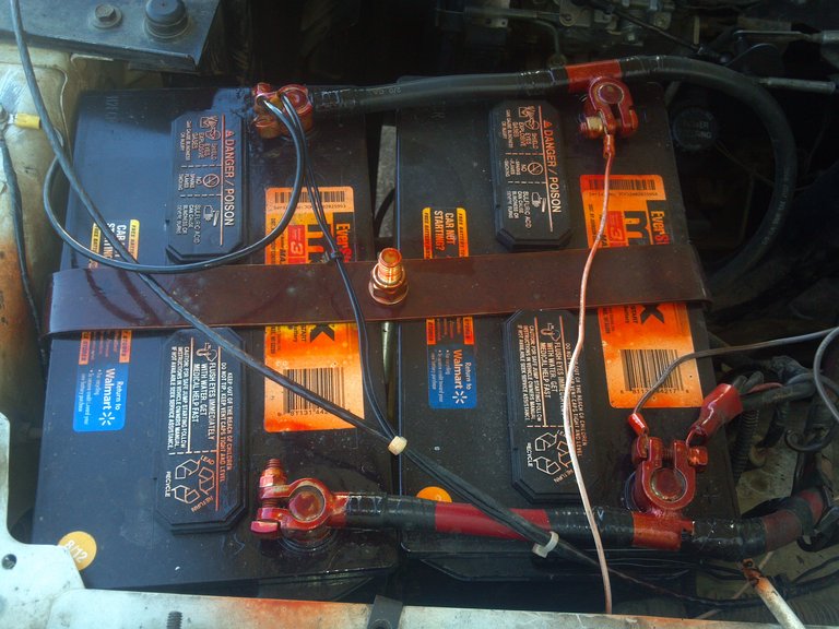

This is how I mounted my 2 wally world batteries 810 CCA each, I use them because they have a 3 year free replacment and a 5 year pro rate.

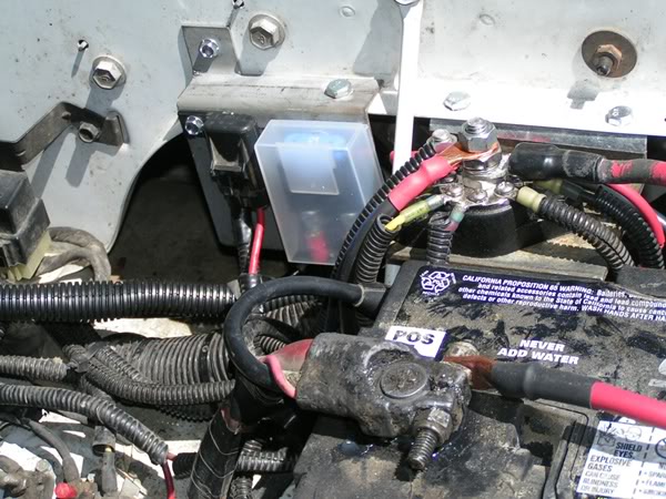

All these battery pictures make me want to show off my hay wire eliminator.
