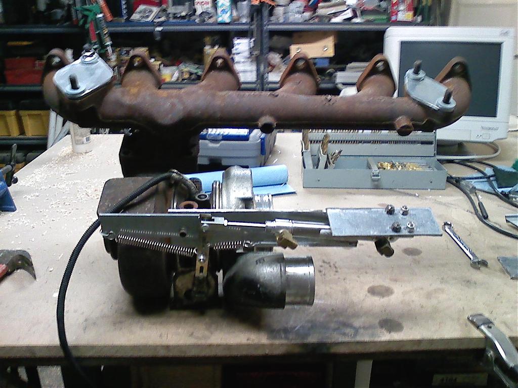

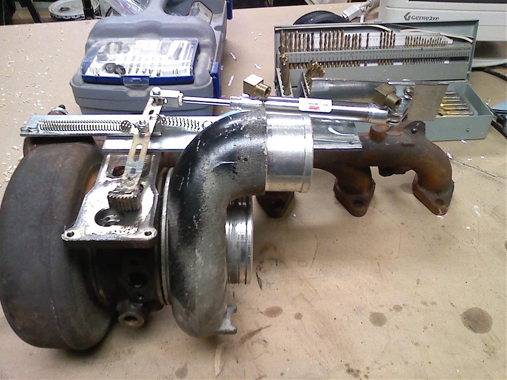

Here are some pics of my setup. I plan on putting it on my truck this weekend.

i was just about to ask how you made a 3rd gen manifold work on a 1st gen, then i read your sig
Attachment 29326
Attachment 29327
Attachment 29328
Is that the costco drill bit set I see in your pics.
Yeah, My apologizes. I realize this is a 12V Thread, but in the end, this is something that can be done on any one of our trucks. I was able to learn so much by reading these threads across many forums. Im just trying to help the next guy.
No, It was my dads set from before he died. It was purchased before i can even remember costco being around. He got it from grainger i believe.
I've got another question, do the springs bring the lever back to the same starting position every time?
Very interested in a report back on how it works! Even if its on a 3rd gen.

Yes, it does bring it back to the same spot every time. However that spot is not exactly were i would like it. It stops a little short, but i have seen all of people reporting back that everything loosens up after it is oiled from the truck. Im hoping this helps.
I will definitley report back.....

Got another question, how did you determine where you want your start point? How do you know you're not getting into EB territory?

As far as i know the EB is all the way closed. Anything less than that should be ok. So i guessed close. I'm not ruling out the need to adjust.
