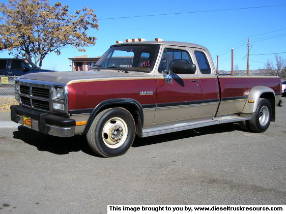

Yeh I think so cause it did come from a Freightliner branch manager. My dad was there looking at getting a new OTR tractor and noticed a "For Sale" sign on the truck and when the salesman said he wanted $6500, my dad immediatley went to the bank to get the $$$. Paid 6k total for it. I'll have to get with the guy who sold it, and ask if he done anything other than the tranny swap. My dad did tell me he mentioned that the stock 1 went out at about 170K mi. and he just replaced it with an NV4500 from a "95 model. It now has 187k mi. so who knows. But knowing how those OTR diesel shops are, he may have had some "free" hp upgrades done to it. I have a pic of it in my gallery, and will post as soon as it's approved.

Here's the pic of it.

Take a pic of the inj pump! if theres paint chiped off the screw on top then some on been in there......and you will be too ...just adj the star wheel 1/4 and the smoke screw1/4 and waw made a lot of diff but my truck didn't smoke at all no mater what!.....it dus now,just a slight hase, and runs better to!

Well, I can't look at it cause I'm at work for the next 2 weeks, but I will ask my dad to send me anothe pic, of the inj. pump. I just wished I couls come by deals like this when I have the $$$ seems they're only around when I don't.
