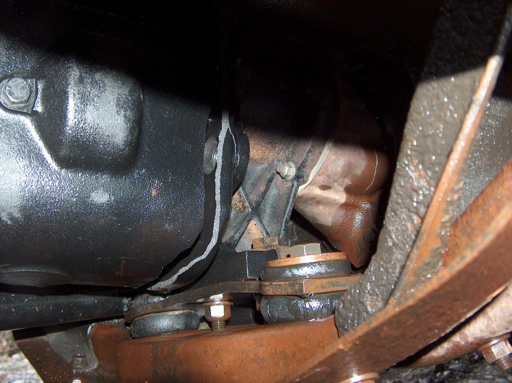

Actually they are terrible. You better pull it out and I'll send you my A518.
