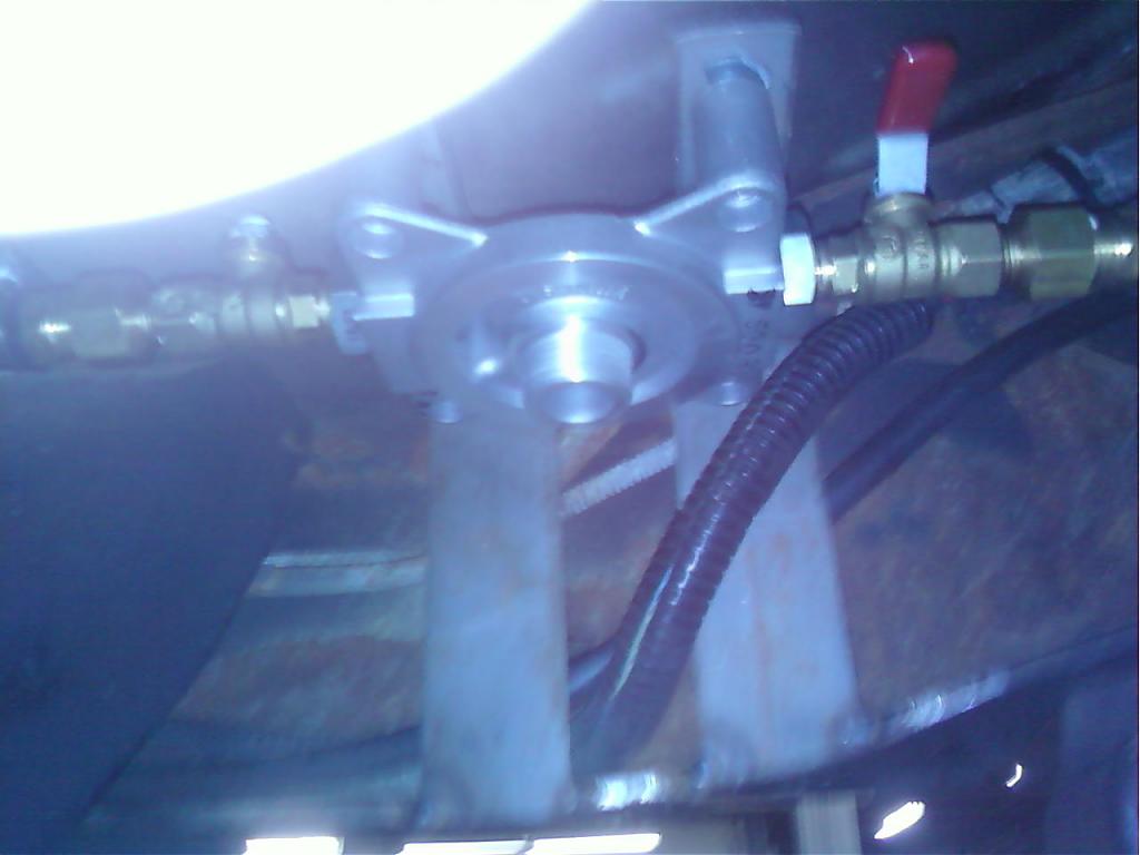

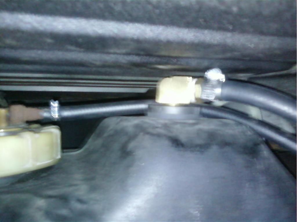

Thought I would share with you guys the fuel system upgrades I just got done putting on my truck. It now has all 1/2" lines from the tank to the injection pump. I made my own 1/2" draw straw from stuff at the hardware store, and have a 1/2" inlet fitting at the injection pump. Im using a High Flow filter head mounted on the frame rail, with shut off valves on both ends to aid in filter service. Im running a carter 100gph electric pump and its making 17psi at idle and 12psi at wot.

do you have a pic or manufacturer for the filter head?

Here is a pic of the filter head, its acually an OEM cummins part. Ill have to see if i can find the part#
