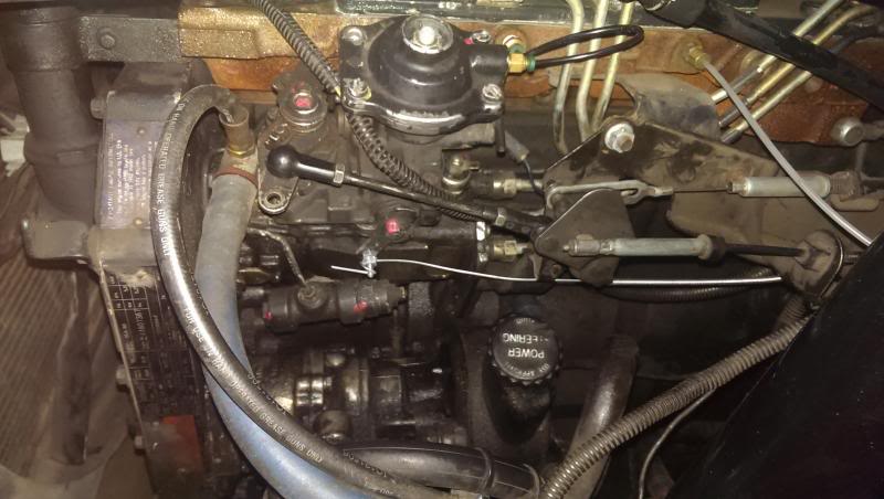

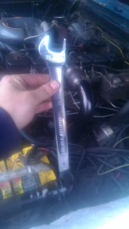

Youll need to cut the bracket off. Its 15/16 in wrench but to fit its gotta look something like this:
I used a dremel to grind the open end down until it would fit. Took quite some time, if you have a bench grinder, it would be faster
Notice how the bracket is gone (shiny metal behind FSS) used my dremel on that too

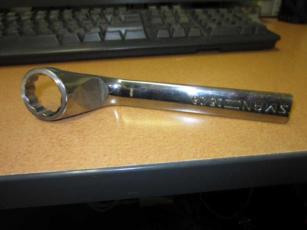

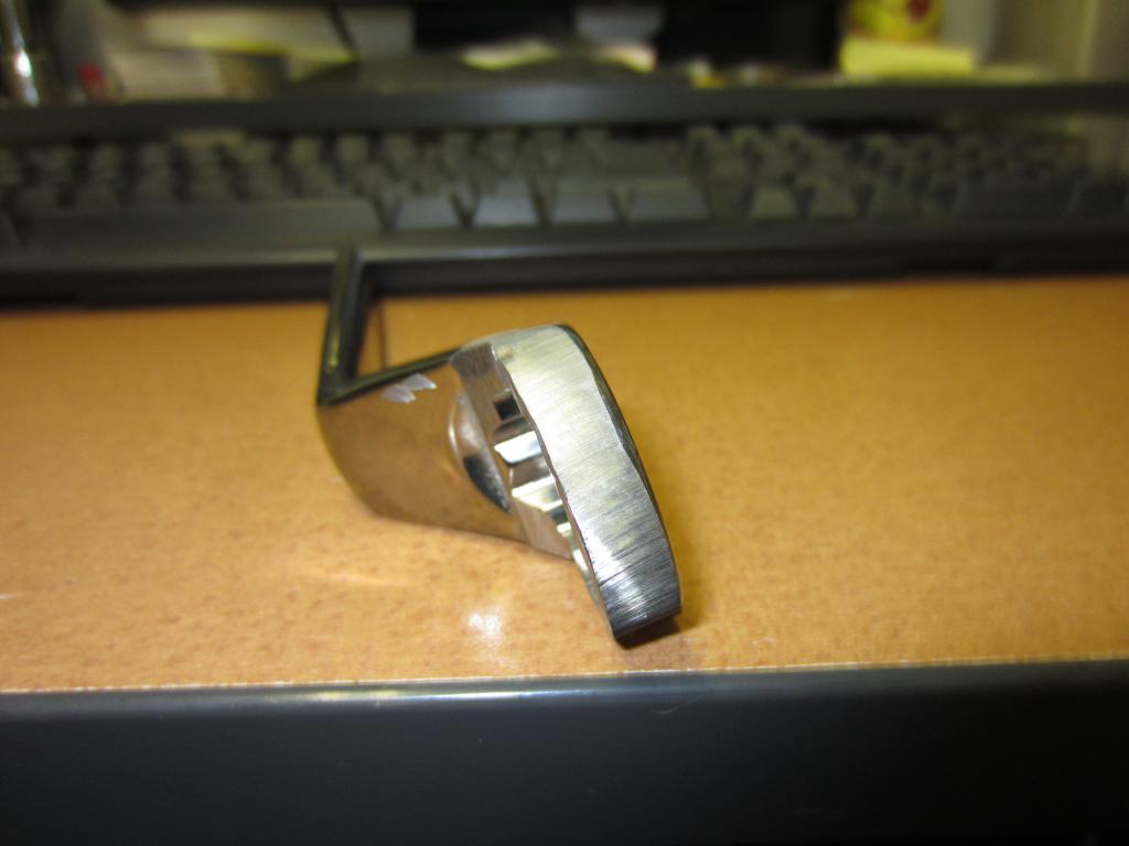

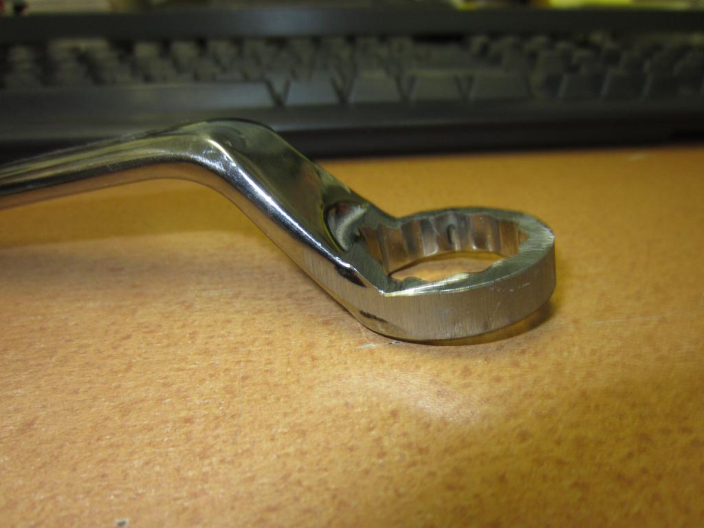

I bought a deep offset 15/16" (I think) box end wrench from Sears. http://www.sears.com/craftsman-profe...5&blockType=G5 I cut it shorter and ground on the box end until it slipped right in there. The right tool for the proper job.

Mine looks like this and you don't have to cut the bracket.
