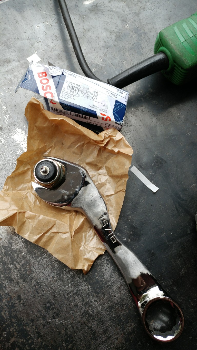

Finally....I have removed the shut off solenoid. I found a wrench to grind down because they wanted $60 plus for a crowfoot; which didn't look like it would fit in there. Thanks for all the ideas and replies.

Made one awhile back, using a offset drop down 15/16" tool, as drifter and doodle bee have done. Also found a small, channel lock type Milwaukee tool as a back up cause I still had problems getting the tool in there.
All that have suggested to grind off the misc. metal on the VE pump bracket are correct, cause it makes getting a tool in there way easier.
When I had to recently pull my VE out to fix tappet cover leak, I found one of Jimbos engine pics, the one with the billet tappet cover shown. I was able to see where, and how much of that material off that bracket had to be removed. So I saw it as an opportune time to do so, when the time comes to replace the FSS.
I have two new spares from Geno's, and am still running the original 23 year old FSS.

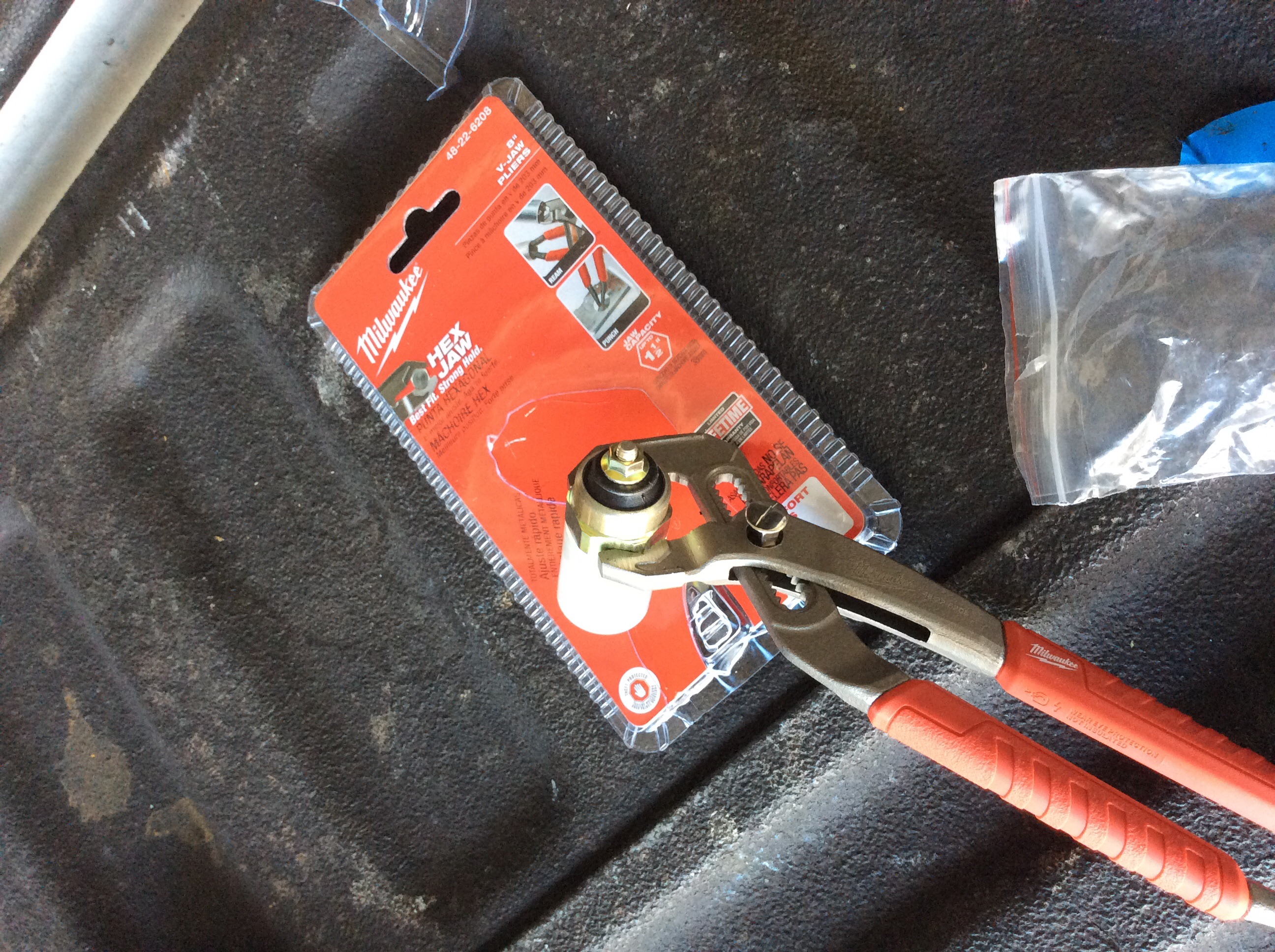

Should by chance my home made tool give me problems, this will get the FSS out no problem. Found at Home Depot.
I want to give credit where credit is due. I googled FSS removal tool long time ago, and did not like the responses of the hammer and chisel, wether it worked or not. I found the idea I believe from Cougar, who used the offset tool instead of a straight on box wrench. If, by chance, it wasn't Cougar I PM'd to get further clarification on fabricating the tool, my apologies. If you're out there and read this, thank you.

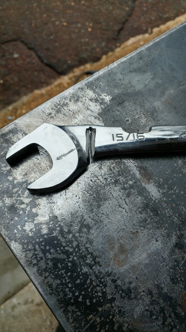

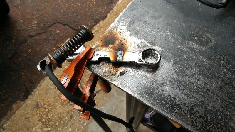

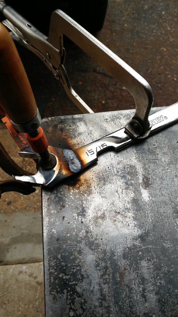

Made my own FSS wrench today. Used a cheap husky wrench and made it specific to our dodge ve pumps.
Cut a notch, then bent the head 10+ degrees as it hit on the handle side. After the head side was ground down, I shortened the wrench 4 inches, for easier access, and less room in the tool box
Fun little project
