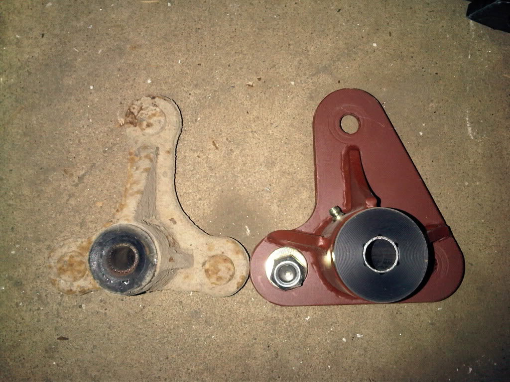

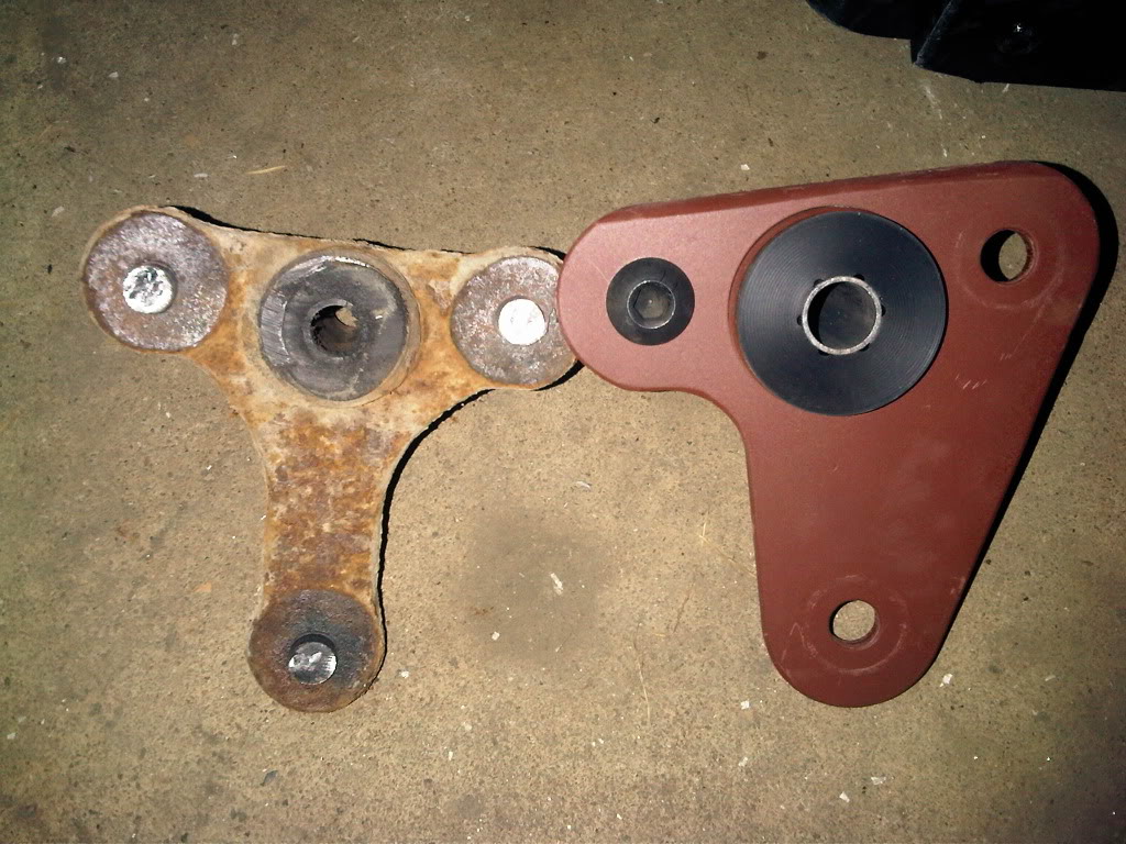

IMO, its easier to replace the bushings/mount with jungles kit although it is more expensive.
http://ramchargercentral.com/jungles...-bushing-kits/

Replaced mine a couple years back. If I ever had to do it again, Jungle's kit is the way to go. Makes them easier to replace a 3rd time, as you can just unbolt them, replace the bushings on a bench, and bolt them back in again.
They were a real PITA to change.... and much easier if the exhaust system is being replaced at the same time.
