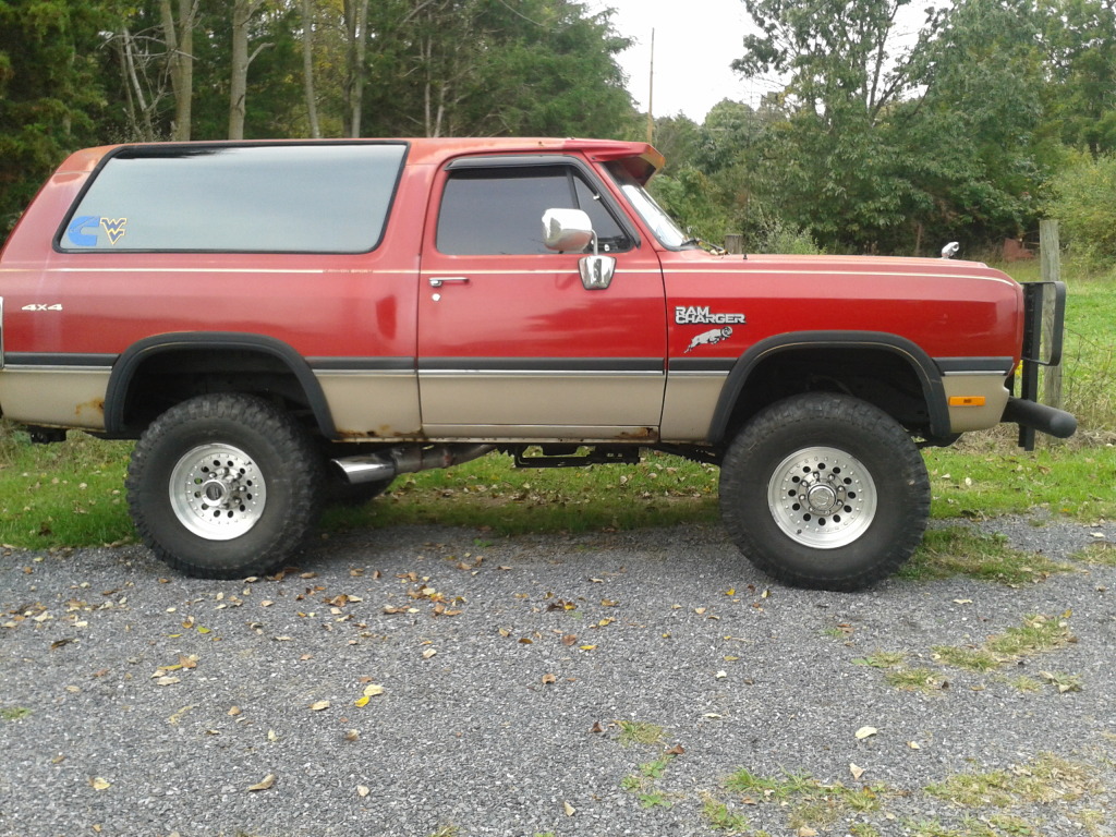

I have Kelderman front air ride suspensions on both my 92 W350 and my 92 Cummins RC. Both ride nice and levels out the truck nicely.

That looks like what i need. What kind of air pressure do you have run in the bags. Also can you only buy them from Kelderman online or is there any other places that sell them
Old Oct 16, 2014 | 07:07 PM
freight train's Avatar
Posts: 1,642
Likes: 96
From: Martinsburg WV
I have different pressures in the W350 than I do the RC. The RC I believe I carry 25lbs due to the lift I have on it (about 4"). The W350 I believe it was 18lbs since I only wanted about 2" of lift. I got lucky and bought both of my kits used. I did order new bags through my local Napa due to the original ones having dry rot cracks. They held air but I wanted to only install them once. The kit is available directly through Kelderman. I am not sure if its available anywhere else. Warning, the kits are not cheap. But you get what you pay for. The craftsmanship is really good on the upper and lower mounts and the tank mounts directly under the radiator support. Newer kits do not utilize the high pressure air hose. They use a nylon plastic line.

I have Firestone Air Rides in the rear of my D-350 and the pressure/wt-ratio is 1-PSI = 10 lbs .
lift.
Are the front airbags helpers or do they carry the full weight of the vehicle, from your PSI I would think only helper.
OK I see your springs.
BTW that looks too nice to get dirty.
Jim

Originally Posted by Zeb Christensen
Do you remember what the part numbers were on the air bags that your bought through Napa.
Here you go Zeb Firestone #W01-358-2131
Thank you Jim. I wish it was as clean as your dually
