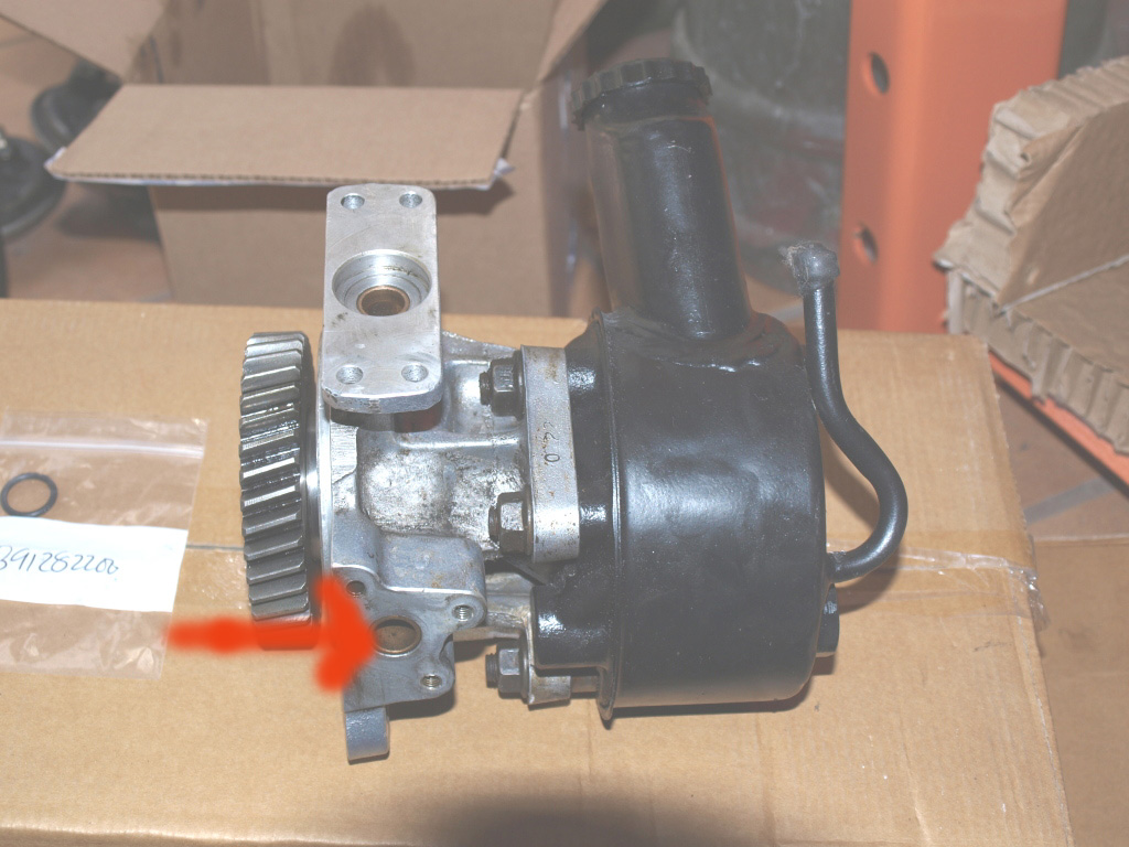

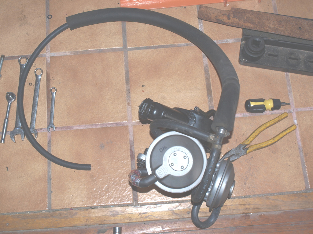

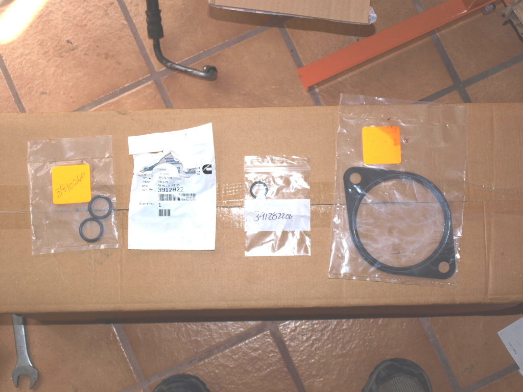

Here are some pics and Part numbers:
Gasket x 1....Have to find this 1
Vacuum pump pod O-rings x 2 These come with the remans... 3910260
larger O-ring between Power steering and vac pump... 3912822
O-ring below pod adapter...391282200
The arrow shows where O-ring below adapter goes.

I am a little confused; are we getting the whole nine yards, power-steering pump and all; or, the entire vacuum-pump unit itself minus the PS-pump; or, are we just getting the two replacement pods ??
Thanks.
Thanks.
No, just the pods, although I did replace the pump, hoses and all o-rings and seals and the gasket. Also. the pods from rock auto come with the o-rings for them, except the one that goes under the adapter plate. I have to say that it cured ALL of my leaks Mark
