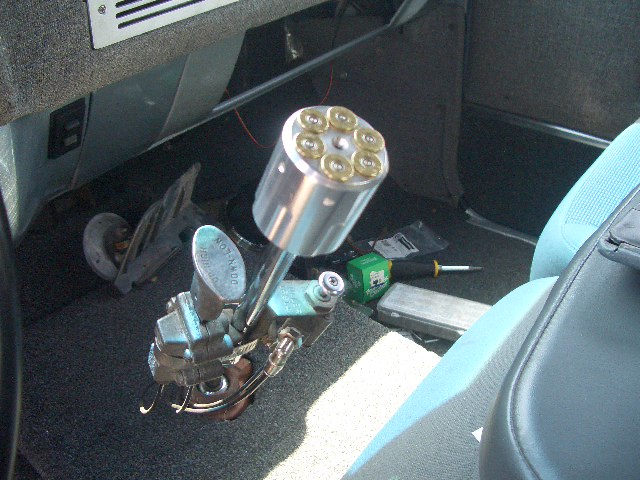

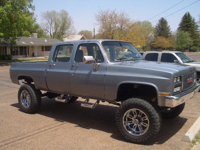

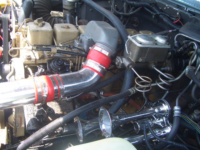

I built an 85 CC chevy with a first gen bolted up to an rto 610 with a divorced NP 205. Initially I didn't like it. The hardest part was finding the right slave cylinder. Now that I'm starting to get the bugs worked out I love the truck. It's taken some time to get used to the trans but I can start in as high as 5th with 37" tires but I'm going to regear it to allow me to use the lower gears.. I really only use half of the gears. I did not put a body lift on the truck because I hate them but I did have to modify the hump and my gas pedal but it looks great.

Other than the bell housing, everything else was fabricated. All cross members and mounts were made for the truck. I would strongly suggest that what ever tranny you use, try to find a driver side starter bell housing. Mine isn't and I had a heck of a time with the exhaust. Also, You need to be careful of the torque that ou could potentially make. I bent the frame and had to box everything and get the frame straightened.
