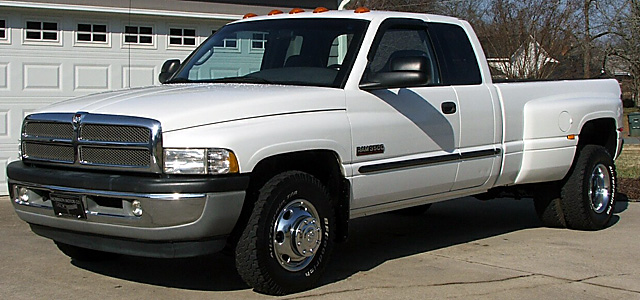

Okay, I've read in the sticky and other posts but haven't really read much on fitting 2nd gen dually rims on a first gen. I'm want to install these rims on this truck and wandering if it will work. And not these particular rims I'll still need to find a set. Or more headache than its worth?

I seen them on other fist gen bolt patterns shouldent be different find a friend that has a spare and see if it fits

The "experts" will start telling you about lug-centric vs. hub-centric differences in wheels, but I have run 2nd gen inners and aftermarket outers (and fronts) for 15 yrs with no issues. The bolt holes may need some slight enlarging depending on the particular wheel (5/8 vs 9/16 stud size), but the most I have needed to drill was 1/16. My machinist said I could do this at home, and I did w/no ill effects.

dodgenstein has it right I have also been running 2nd gen wheels for many years now. Had to drill the holes just a little bit.
I use my 2nd gen wheels for my drag tires..

I put the third gen wheels on my truck and all I did was drill out the holes with a step bit on either side of the rim, since the third gens have 9/16" studs and our dually's have 5/8" studs. No weird vibrations came up or anything of that nature. The Only thing was I wasn't able to use the center cap that came with the simulators so I just use my stock caps. Wheels look good though!!
