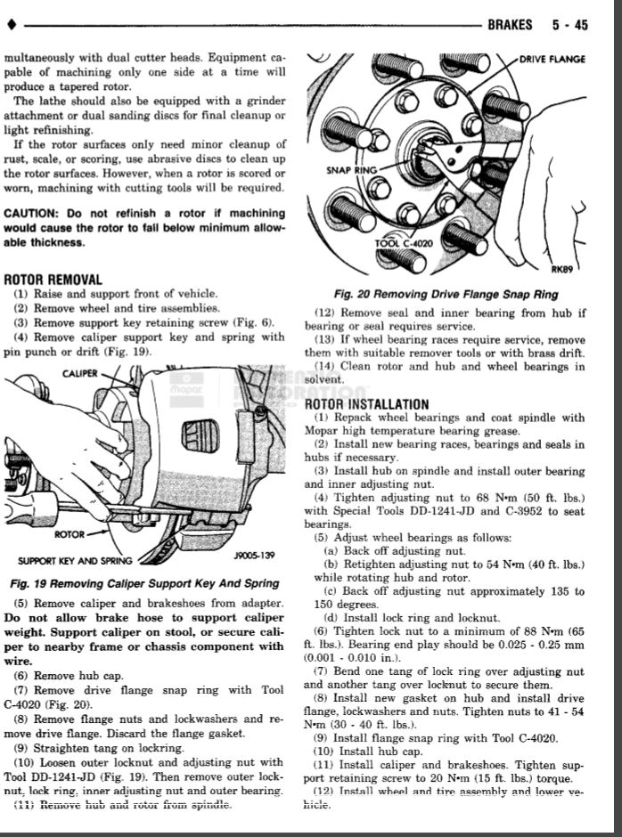

Fake FSM Specifications.....
What year FSM is that page from. My 89 FSM doesn't have that. It especially doesn't have the Dually front hubs for the 2WD which are very different from the standard or 4WD hubs. My FSM says absolutely nothing about tightening spindle bearings.
So basically I have it that the nut should be tightened enough to seat the bearing races and then backed of and tightened enough to compress the grease out for ZERO clearance and backed off enough to give .001 to .010 clearance.
THAT'S a lot of variance.
Edwin
Old May 16, 2017 | 10:31 PM
Edwin
1992. As you mentioned...its disorganized and non intuitive as to where things are and should be. There is a wheel bearing section in the axle chapter, and it's for 1/2 ton trucks. The same pertinent info for 3/4 and 1 ton is in the brakes chapter.
Very disorganized.

Translated to the real world where both bearings and threads wear:
Tighten it down to seat the bearings.
Back it off, and take it down to just snug while rotating the wheel.
Back it off again and set it to where you can just barely feel end play.
Here's where the thread wear comes in. Set the retainer and tighten the lock nut. Check for end play again. If the threads are worn (likely) the lock nut will take a few thousanth's of end play out by moving the inside nut from the outside face of the threads to the inside face. If it does you have to back it off and back up the inside nut one tab.
Better yet, install Stage 8 x-locker spindle nuts and you have the simplicity of adjusting a nylock spindle nut and better retention than the 2 nut bend a tab system.
