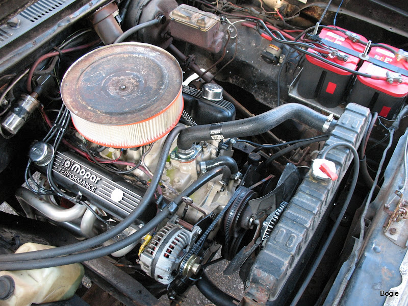

Dual Optimias fit in my gasser
How many CCA each?
Old Dec 14, 2010 | 04:53 AM
Bogie's Avatar
Posts: 228
From: Queens, NY
800 @ 0f
They fit the same in a CTD.
