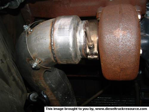

The only reason source has their down pipe with a flange is because stans came out with their's all welded with a flange. I got mine from source before this so I had to weld my own flange on there.
If you ever think you might upgrade turbos you ought to get the DP with the 4" hx-40 type flange.

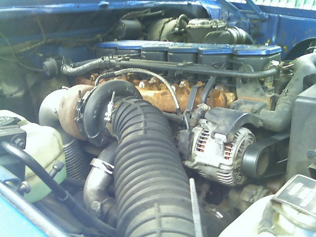

Home made is cheaper and just as good. Bad pic, sorry. Just sold the truck today, so can't take any better pics.

So The Stans HX-40 Downpipe has a 4" flange, and I can buy an adaptor to go from 4" to 3"? Is that correct? Will I still have clearance between the turbo and the firewall? (hx-35 sits about an inch farther back than the h1-c.)

i don't know if you could buy a flange from them, but wherever you get it, you'd need 2 v-band clamps. i'd say buy the downpipe for the h1c for now. when the time comes for an hx40 or any other turbo with a 4" outlet, cut off the 3" flange from the downpipe and have this welded onto it...

That isn't the right one for the HX-40 style.
you need this one:
http://store.airflo.com/ad411.html
