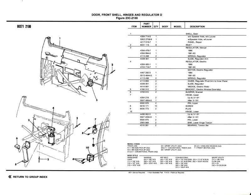

Here are the part numbers for the door hinges, note the part numbers are different before and after build date of 03/01/1991
Also notice the Lower Hinge Torsion Bar were sold separately #2583-568
Last time i had checked I thought the hinges were about $70.00 each but I could be mistaken.
Jim
