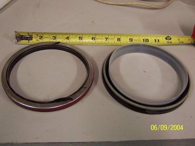

My seal looked like this and it only leaked a little. You can see the pieces of the seal sticking out. If your seal is original it probably looks the same. The new seal from Cummins was updated and I don't think it will deteriorate like this one did. Hopefully anyway

to add to my original post... i replaced mine back in february when the new clutch went in. my original wasn't leaking but i replaced because of just that, it was the original. and like in many cases, when working on things, i don't wanna rely on the original 20 year old part to last much longer than it already has. i haven't seen a single drop with the new one.
