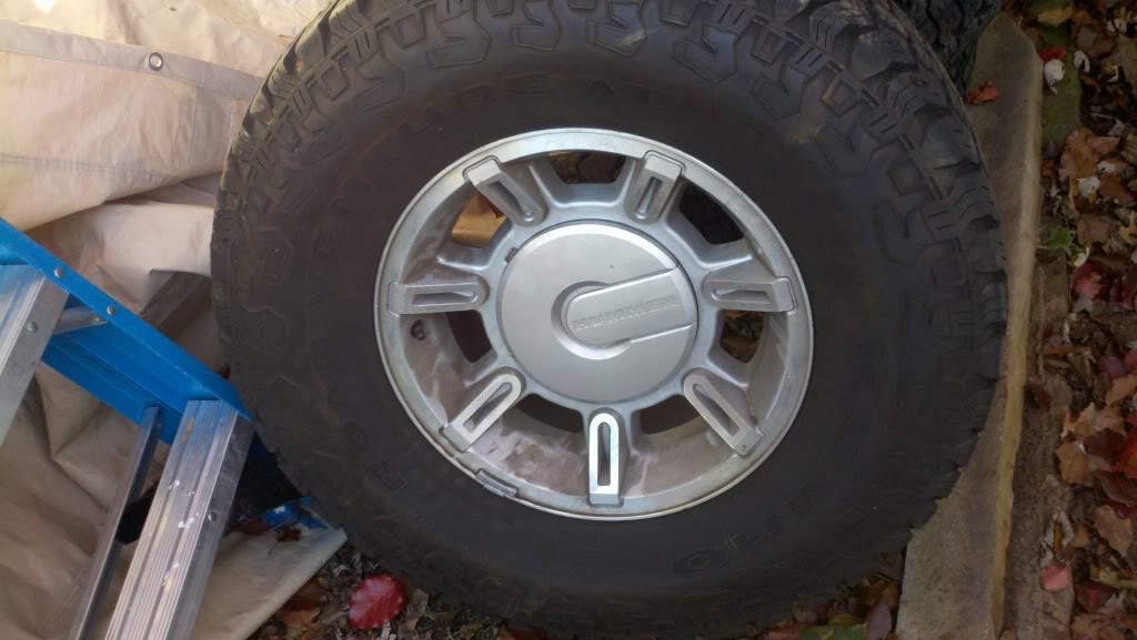

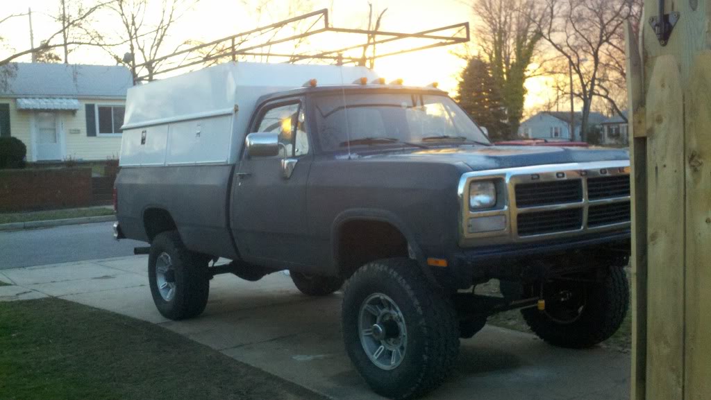

And here is what she looks like now both with and with out my work cap:

Right now i'm trying to figure out what color to paint it, as you can see in the pics half of it is in primer and has been smoothed and repaired and I still need to do the driver's side. Anyway let me know what you think, Thanks!

I'm liking the hummer wheels I'll have to look for a set.
