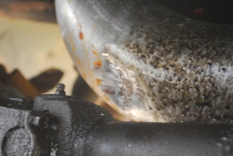

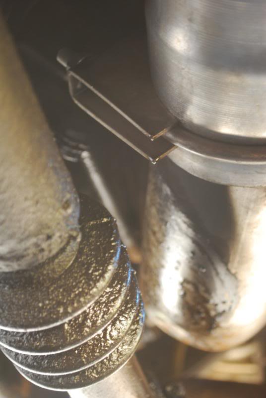

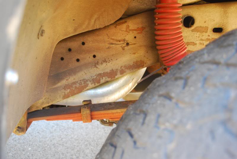

just a few shots of what you get with 4" dp and stock springs that are pretty well beat up

well, it'll still out-flow at 3" exhaust hands down, but that sucks about the damage ...

Seen that before! Downpipes are not bump stops .

Same happened to my sourceautomotive down pipe. Same spot.

My 93 DE kit,, same thing. My 89 Stans kit, no hit.

My stans pipe hit, but I guess thats what happens when you hang 1500-2000 lbs on stock saggy springs. after the lift it doesn't hit.
Well I just got some 3" skyjackers for the front and I hope this will fix this issue.

I got D400cs, I just went to my local shop and told them I want 3" front springs for 92' cummins. And thats what he ordered for me
I have no time this weekend but maybe this week or next weekend I want to put them in. It should make the difference I need to get the driveshaft yoke away from the down pipe.

i have the D200c's , i like them, ride is good and no hitting my diamond eye. raised it so it sits level now.
