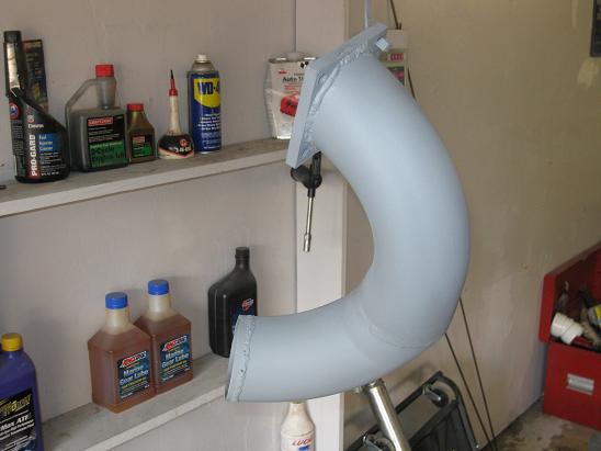

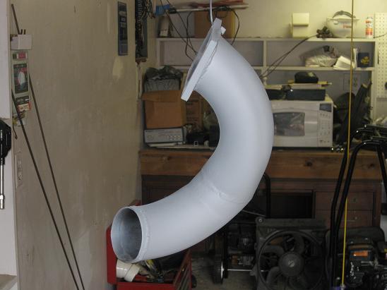

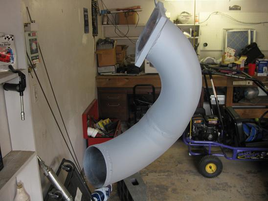

I got the new 3.5" mouthpiece all welded up today and have it primered. I'm going to paint it Garnet Red to match the rest of the truck when I get it repainted. (once I finnish all the body work)
Here is a couple pics.

Sweet! I would replace that 12mm exhaust housing, it's limiting your flow.

Why paint? I thought it was stainless?
