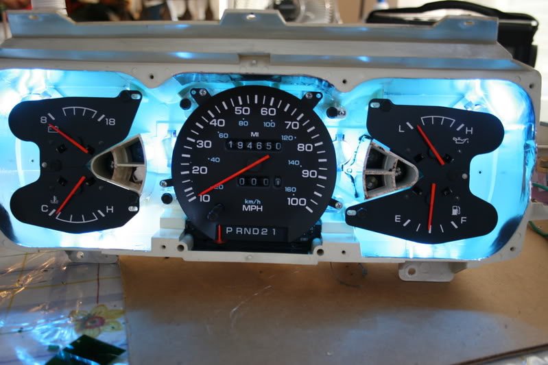

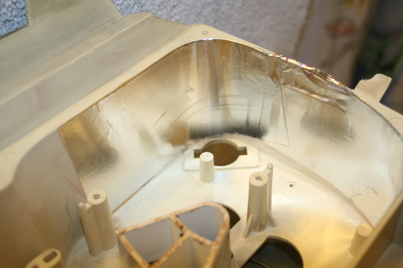

That reflective surface really makes a difference doesn't it?
My lights are BRIGHT.
By doing this.
You get this.

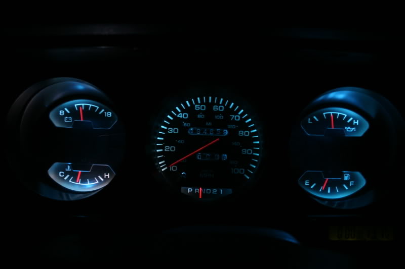

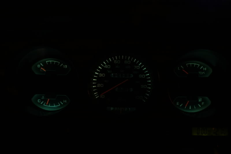

Here's mine. I did almost every square inch of the inside of the housing i could, even did the back of the black surround which took forever, then I polished the lens with plastic cleaner and hit it with some Meguiars Swirl-X in a radial motion
They look pink in the pic but they're a very bright red, very bright lol.
Old Jun 3, 2011 | 06:16 AM
Crossy's son's Avatar
So bright the camera makes them look goofy LOL.....there are no hot spots or anything.
