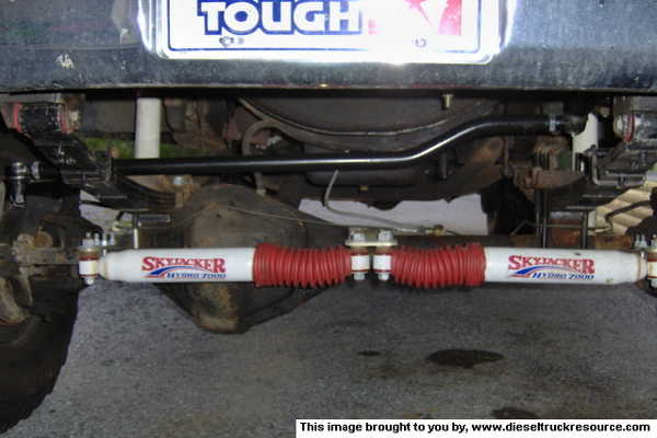

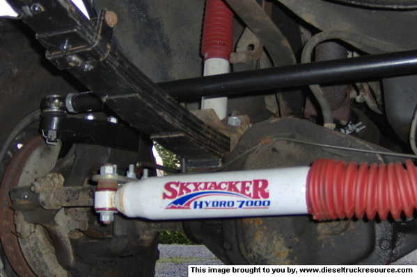

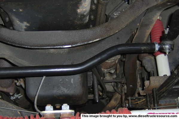

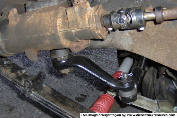

heres a few pics...
[IMG][/IMG]

[IMG][/IMG]

[IMG][/IMG]

how much was that skyjacker lift? how much room in between the bump stops and the springs?

[IMG][/IMG]

[IMG][/IMG]

I think I am gonna order one up next week along with having my box tightend up a little more like a newer truck. Around how $$ for that conv.

Thanks for the pic's, looks clean.
DNR, here's a link to Sky mfg.http://www.sky-manufacturing.com/new...uct.php?id=164

With shipping, I believe is was somewhere around $426.00. It took about 2 weeks to get. I would buy from them again.
