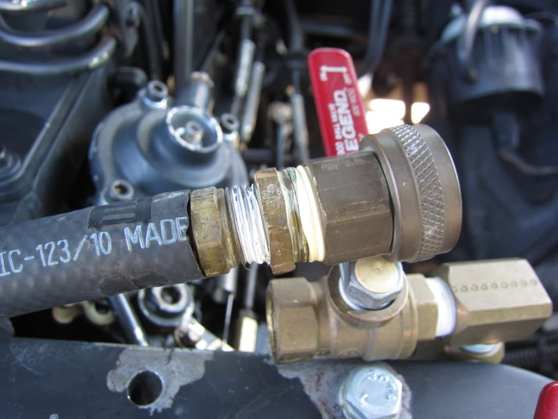

But I have extra parts on my truck since then so I will have to find a new way to get fresh water into my cooling system, I removed one of the hoses leading to the coolant filter from the top of the thermostat housing and added a female hose connector.
Now by adding a simple ball valve shutoff you can get at your local hardware store you can now control your back-flush without having to run to the faucet when it blows like Old Faithful

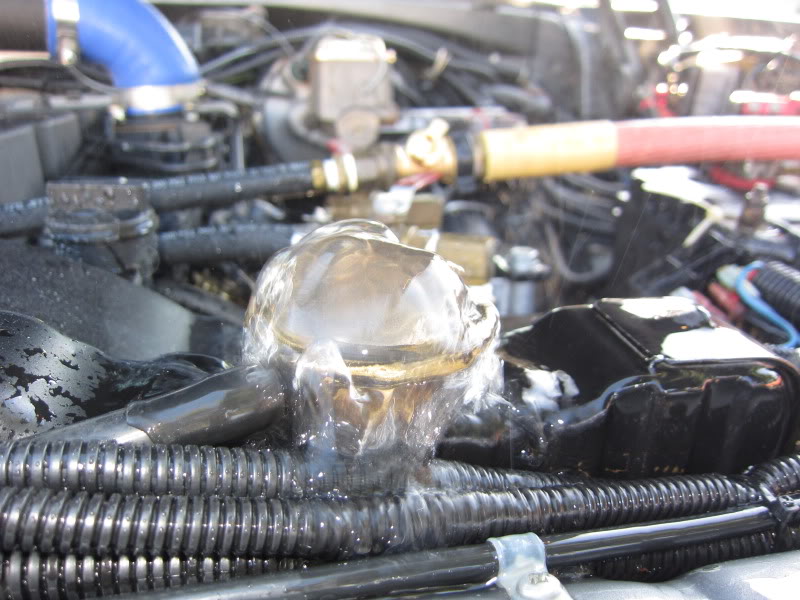

So on a COOL engine I slid my big 3' square aluminum pan under the truck to catch as much of the old coolant, removed the radiator cap and turned on the water, and to my surprise the only thing that gushed out of the radiator was clean green coolant, wow no ugly brown muck from the block like last time.

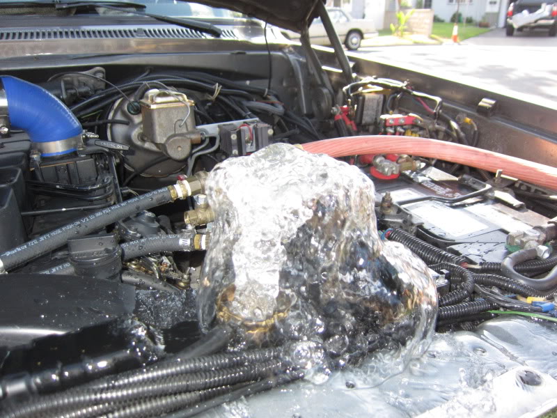

Then I start the engine and run it at a fast idle and within seconds the only thing coming from the radiator was clean clear water so I removed the drain pan and let the rest of the flush into the driveway
With the engine running it is putting up a spray from the water hitting the cooling fan.

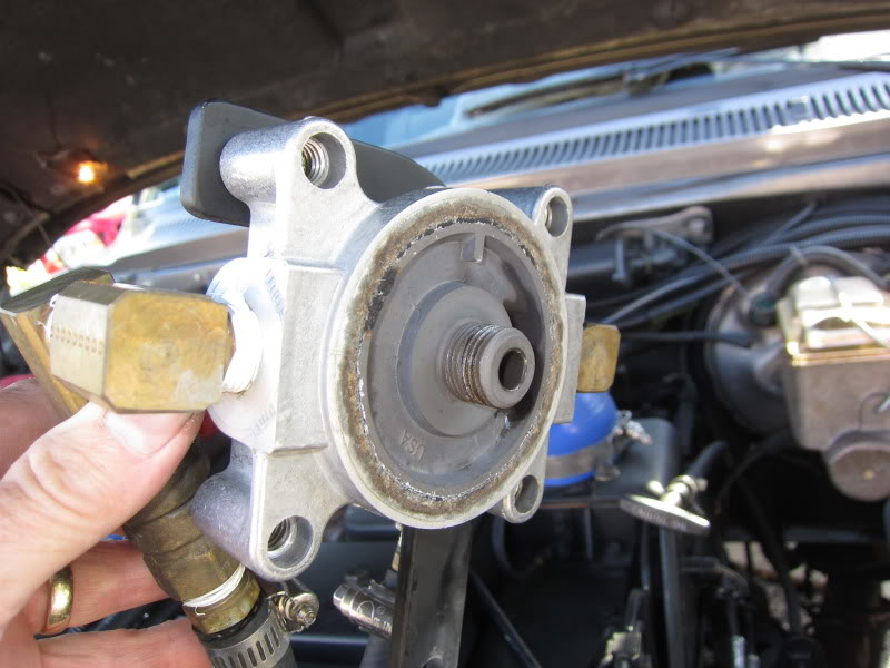

Then I removed my old coolant filter, I had a problem breaking the rubber seal but I got it off with a bit of muscle. see where the gasket stuck to the filter base.

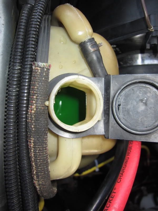

To the empty cooling system I started by adding the coolant and then distilled water until it was to the top of the tank, then I started the engine and let it circulate through the engine block, by venting the air from the thermostat housing I was able to get more it without having to let the thermostat open.
I still could not get all of the coolant/ distilled water mix in so I filled the overflow tank and then went for a drive.
I was also replacing my A/C compressor at the same time.
It took about 2 cycles of filling the overflow tank until it would not take any more and I called it full.

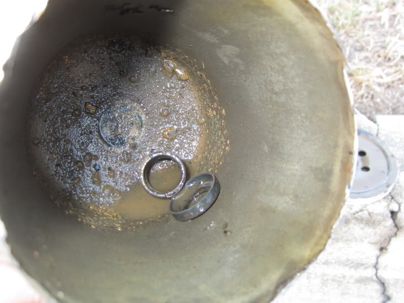

So I cut open the filter housing to see just what had been filtered out of my supposedly clean system.
Yuck, what crud hides inside my engine.
Sick, chunks of what could it be?
This is what got filtered and removed out of my engine block, the leftover casting sand and muck,
