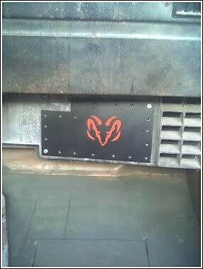

You can do one like this one I did on my 73 crewcab a few years back.

I have seen several "covers" over these home-made clean-out holes that are simply a license-plate screwed over the hole.
Most I have seen are usually of the fake tread-plate back-ground, with either CUMMINS, CUMMINS POWER, DODGE RAM, or the RAM emblem.
They make a real neat cover that looks appropriate.
