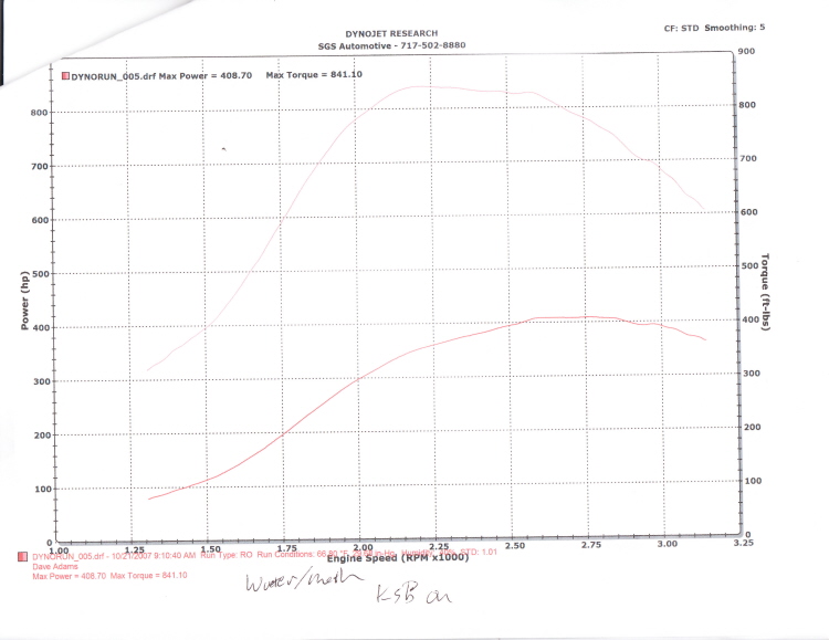

Actually I'd like to see it making peak torque earlier and holding the HP line flat for a while at the top end.
Here's a sheet with a more typical curve shape. Pay no attention to the distance separating the curves, that's just the scaling.

The torque & hp curve peaking together indacates that you are still squirting in more fuel as the engine speed increases -- the torque basically indicates how much fuel you are burning per cycle, while hp increases with speed, right? So if your torque curve keeps going up, you are continuing to inject more fuel -- or at least burn it.
The good news is, that she doesn't seem to be starving out at the top . . .
At least that is how I see it -- anyone have other thoughts?

I think it's peaking real late, maybe due to not getting the turbo spooled right away. What gear did you run in and what was the procedure?
I think with more tuning and maybe some different operator technique there is more power to be had.

With this dyno event, I removed the TPS assembly from the top of the AFC leaving it connected electrically. With that, the transmission goes into OD VERY early and one pretty-much can't get it to drop out with flooring the throttle. As such, I brought the heap up to 40 (+)mph to begin the run (tach presents with less than 1000rpm).
Flooring it has the engine do the typical ramp-up billowing smoke as the engine begins to come up in speed. A second or so later, the turbo lights and immediately clears the smoke and the engine accelerates on up to 3200rpm (about 120+/- mph road speed I think). You can clearly see/hear it do this in the video. The initial belch of smoke prior to the turbo lighting, then the plume of smoke gets blown out of the way with the turbo coming on-line.
I kind of think the graphs are not fully accurate in illustrating the torque jumping with the turbo lighting. I can see very well the engine jump to the right with the truck twisting a little when the turbo spools.
Further, when I'm drag racing, I'll build 10psig boost and launch in 4wd. Shoving a 6400lb truck 60' in 1.85 seconds seems to contradict the plots.
Perhaps the non-lockup converter is skewing things. . . . ?
There are no issues with drivability. Runs just fine AFAIK. No part throttle issues. 70mph presents with about 700*F ~ 800*F with boost around 8 ~ 9psig. I got 200 miles out of roughly just above 1/2 tank to just below 1/4 tank driving to and from the dyno event.
Frankly, I'm sorta stumped as to what I could tune. I do want to clean up the AFC low boost smoke (I think that's gonna require a different spring) else the fuel screw's in just this side of run-away. Static injection timing is dead on 2.0mm. I do race with the KSB energized.
I think, . . .. I need a lot more air.
