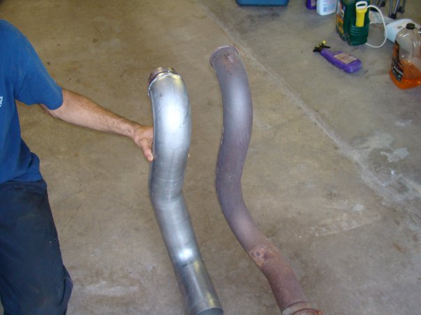

I'm not sure about any of the other brands but the stans system is amazing. All mandrel bent and fits great. I don't see how anyone could make one that is any better.
Attached Thumbnails can't find 4" turbo back exahust 92 dodge-exhaust.jpg   can't find 4" turbo back exahust 92 dodge-exhaust2.jpg

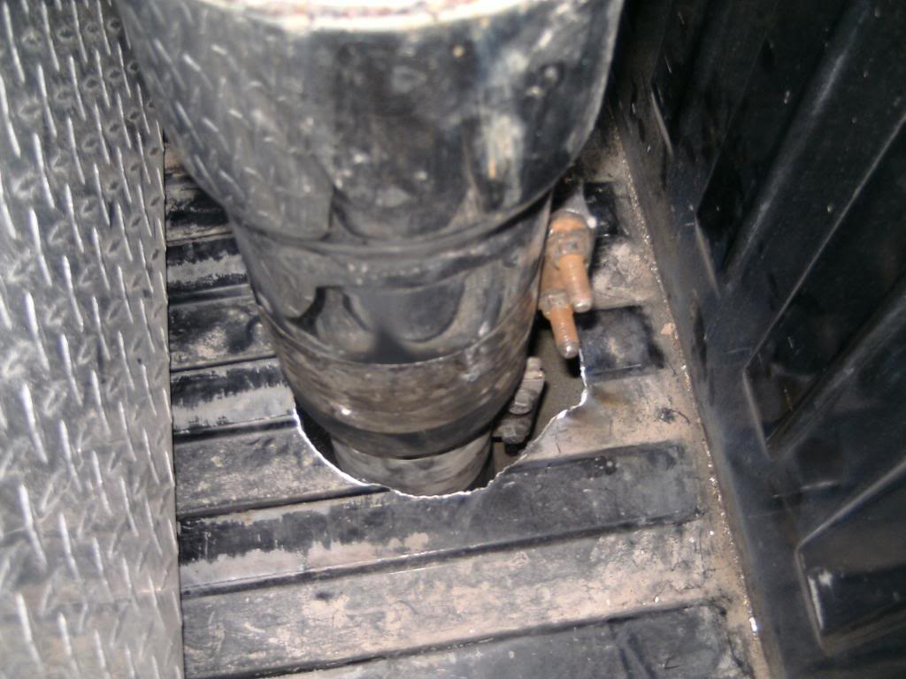

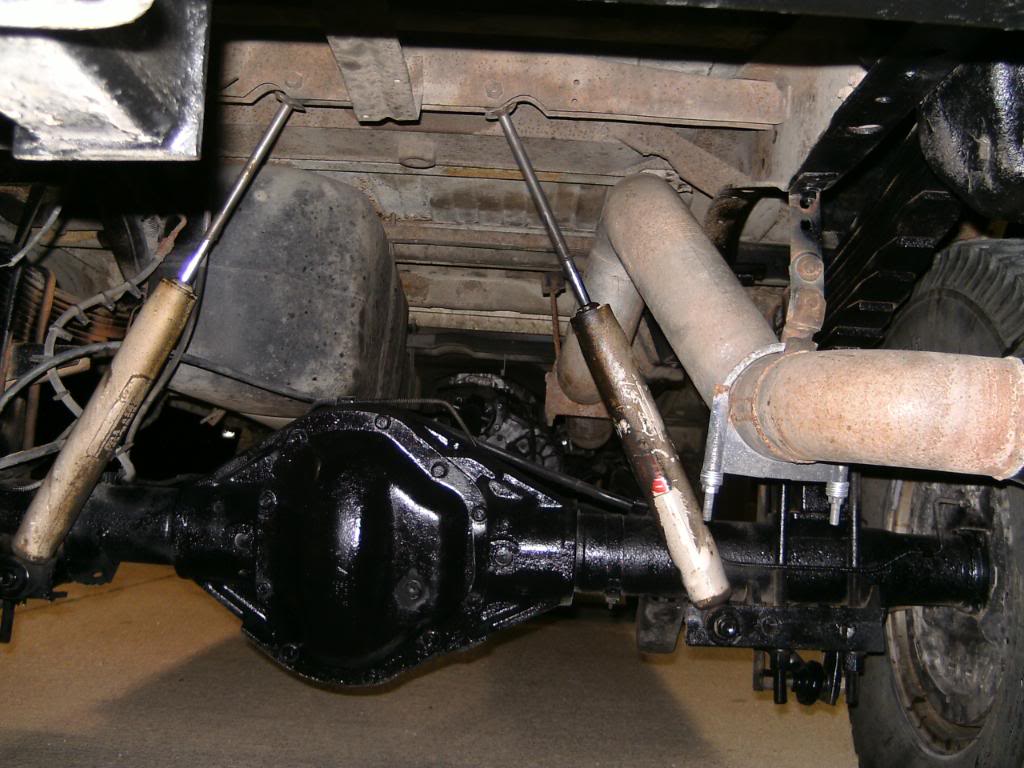

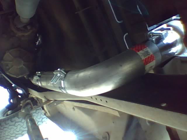

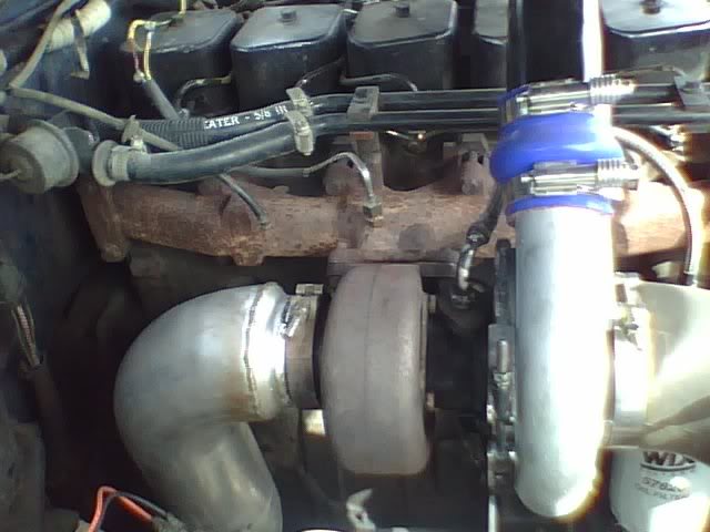

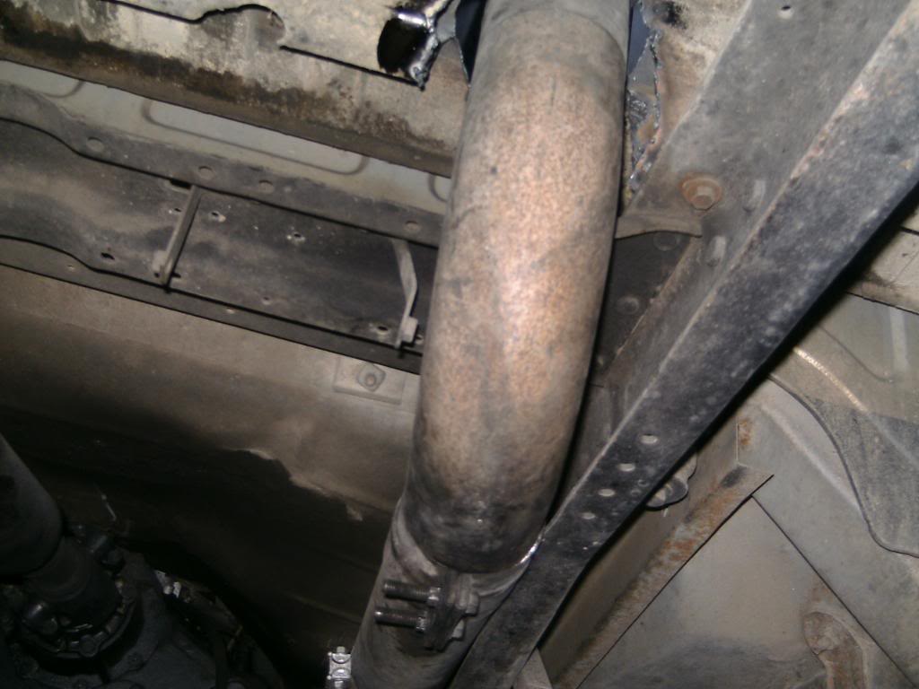

I have no experiance with Rip's setup nor have I seen one in person but I havn't heard anything bad about his system. I do however have experiance with the Stans parts and can tell you that they are top notch quality, when I got mine I just ordered the DP and t-case pipe cause I was running a single stack setup at the time. I am now running the Stans stuff from the turbo to the back of the t-case with a homade muff delete with an old Flo-Pro 4" tail section made for a 1st gen.

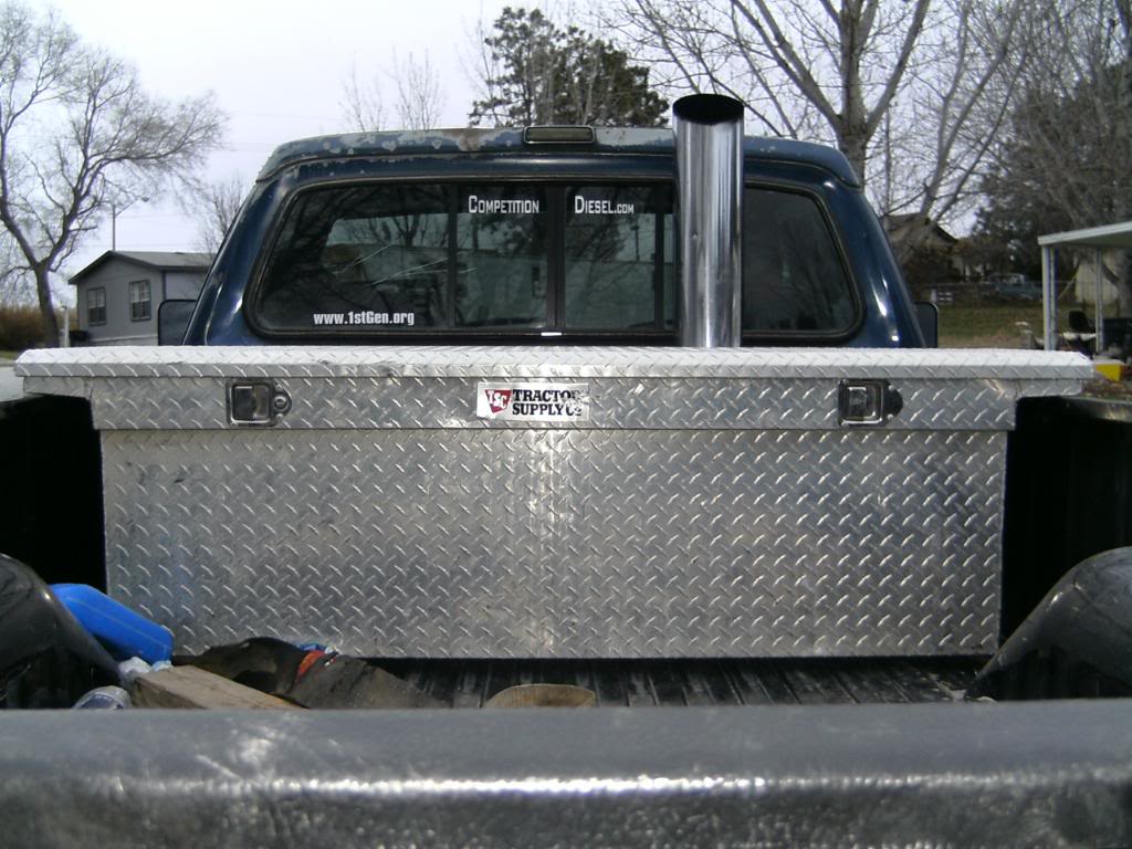

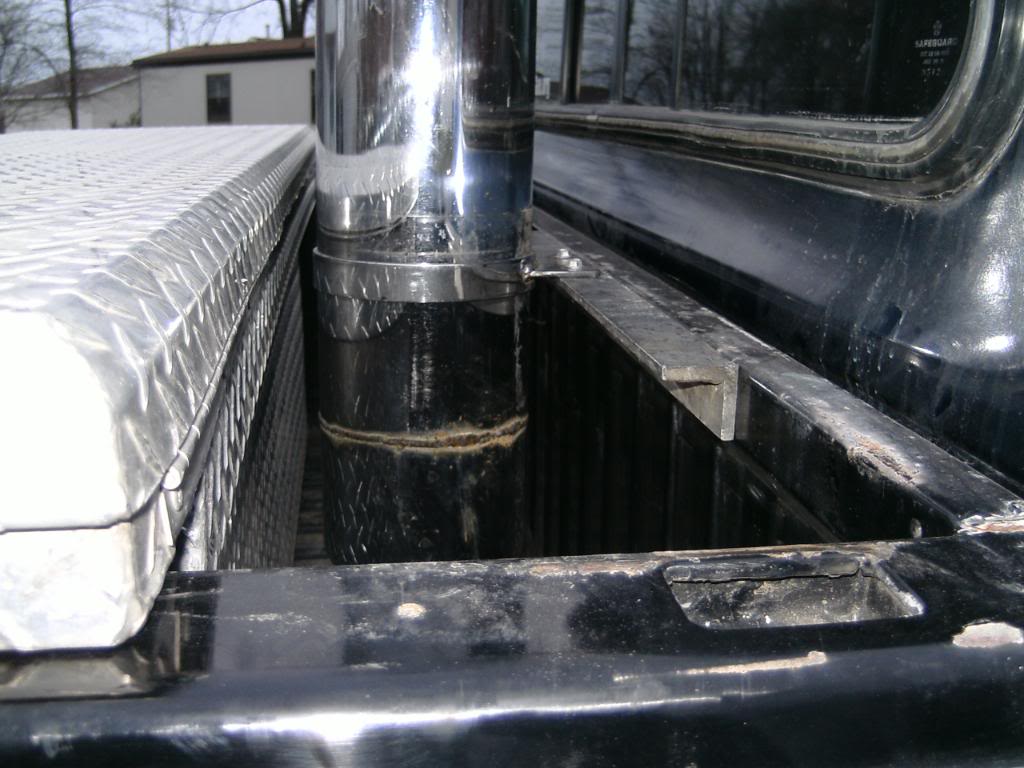

also i really want to put stacks on the truck eventualy but if i'm doing the exahust now i might consider it. "pulltilbroke" how did you have your stack mounted in the bed?

This is how my stack was mounted

great thanks, i was un sure how to mount them to the box
thanks for the pics
