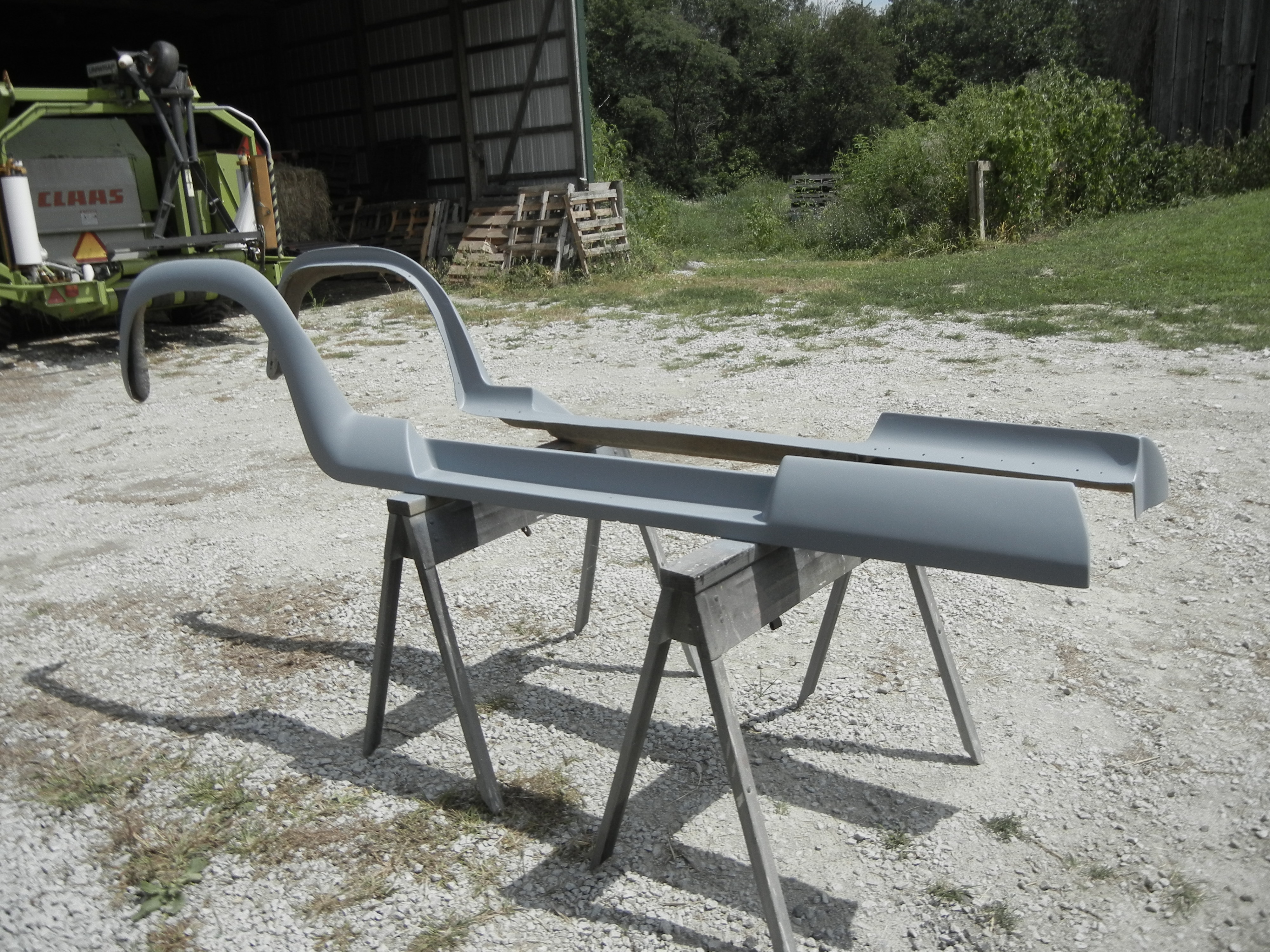

Big you prep the fiberglass just like metal. If any of the old paint is flaking remove all the paint. Prime and bondo as needed. Wet sand and throw your color at it.
My running boards are fiber glass also. Here is a pic of them in primer. These boards had hair line cracks in the paint. I removed all of the old paint. I didn't have to do any bondo work.

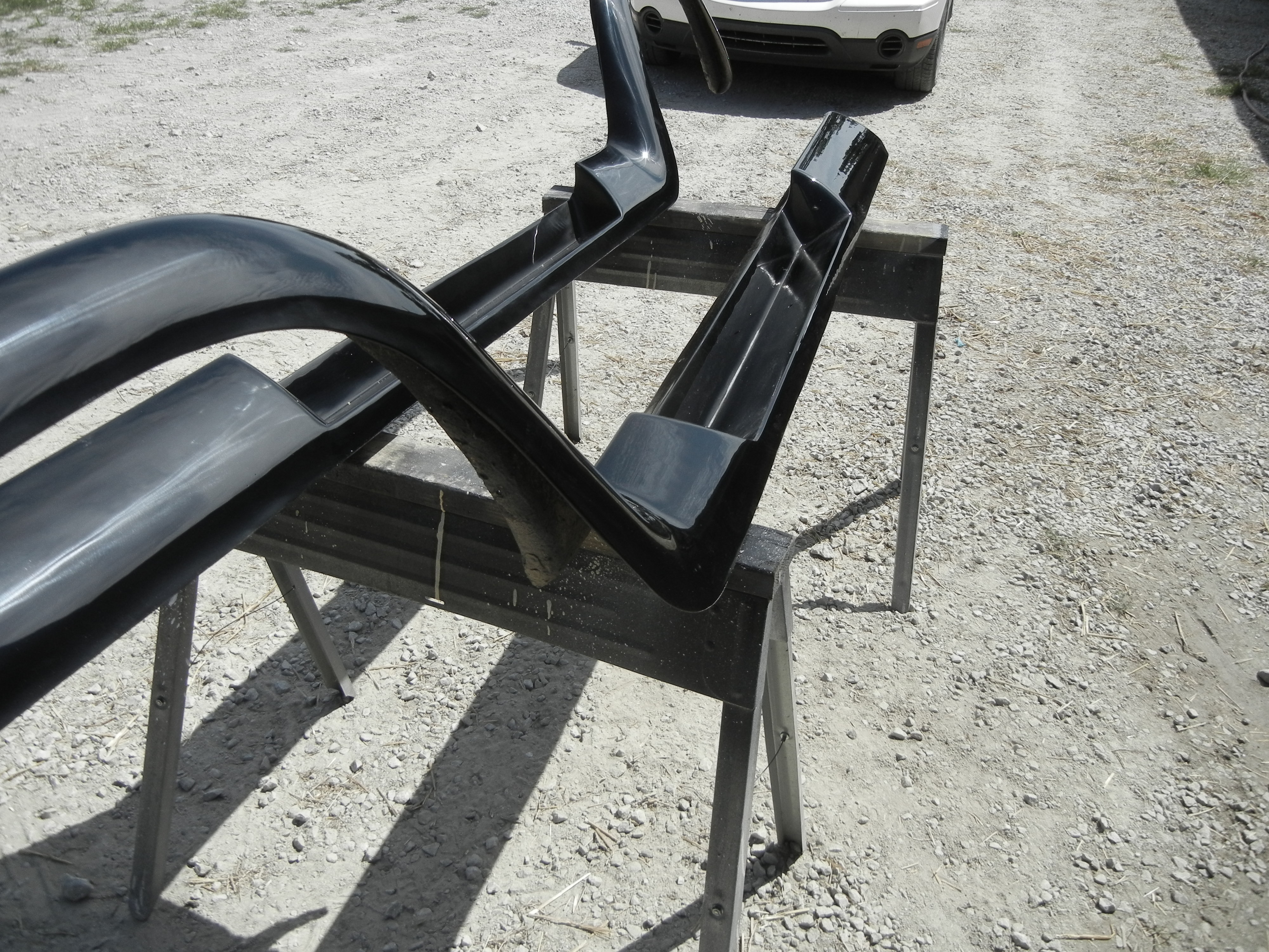

Here is a pic after being buffed out.

Phillip, those mounting on your 1st Gen? Where did you find those? Slick lookin'. No problem holding body weight on those steps?

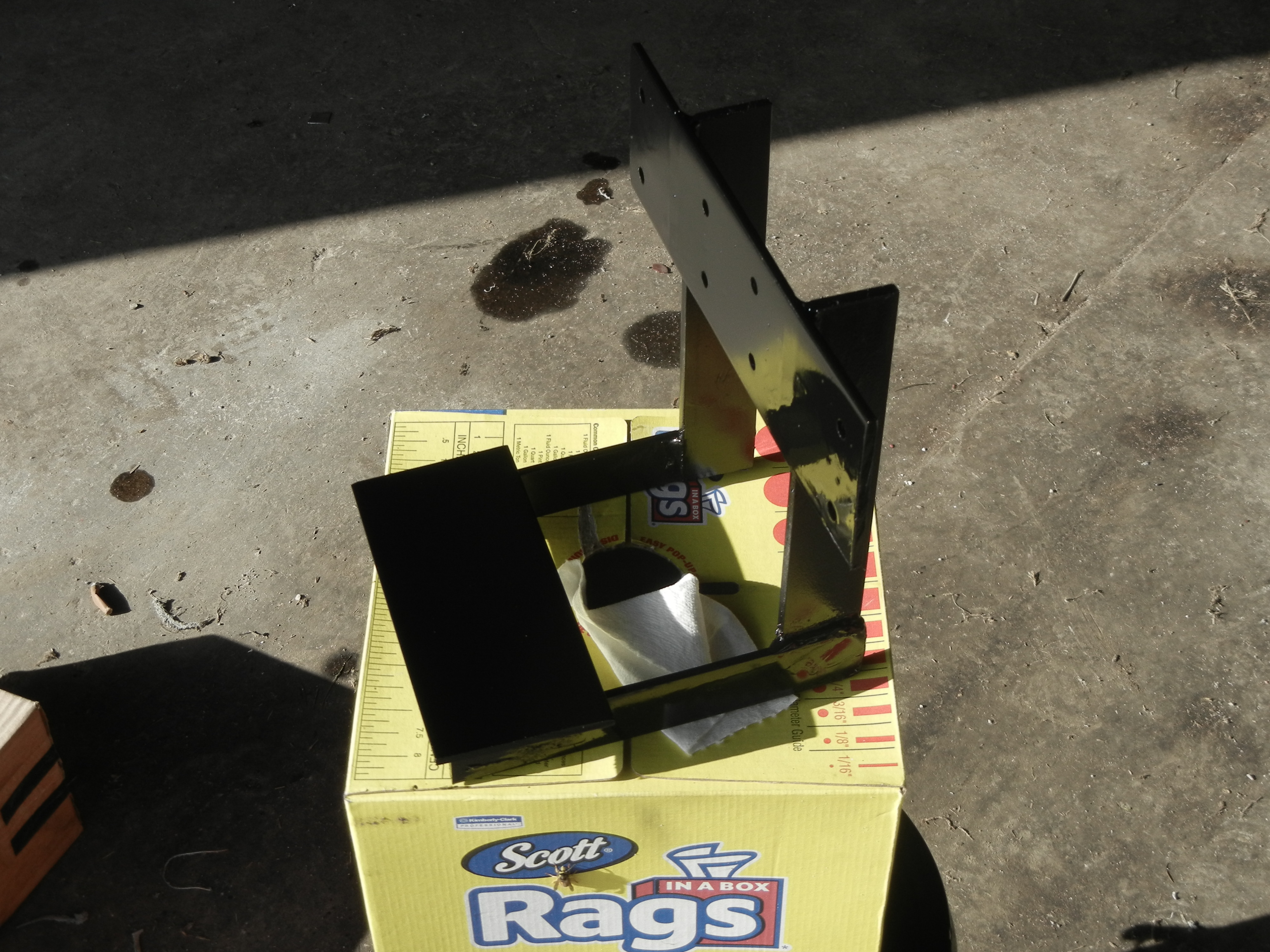

Those are after market fiber glass steps. The only trucks I have ever seen them on were centurion conversion trucks. It took me 5 years to find a set of them used. I had to make a center support for the step part. I could see where it had a support under the step. I did not get them with the boards. So I made a set up.
Here is what I made.

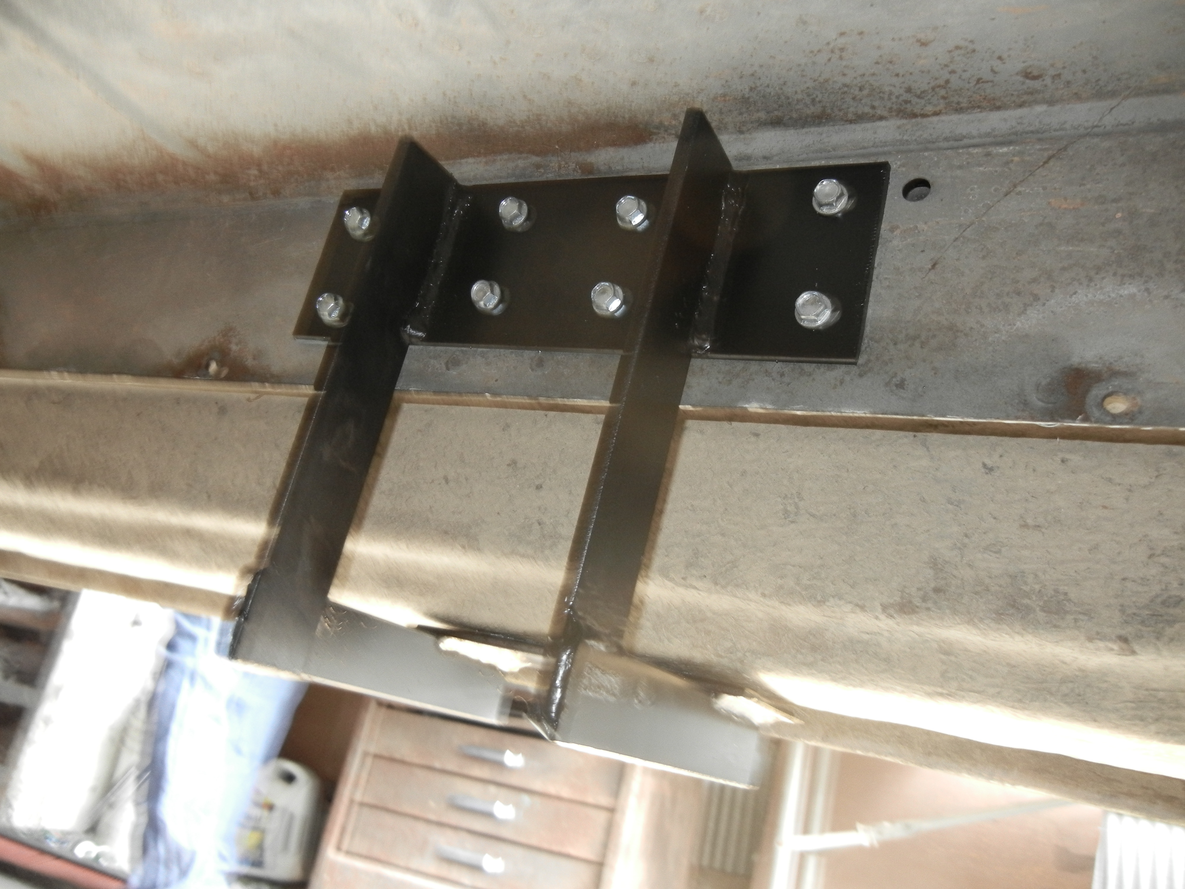

Here is a pic of it installed.

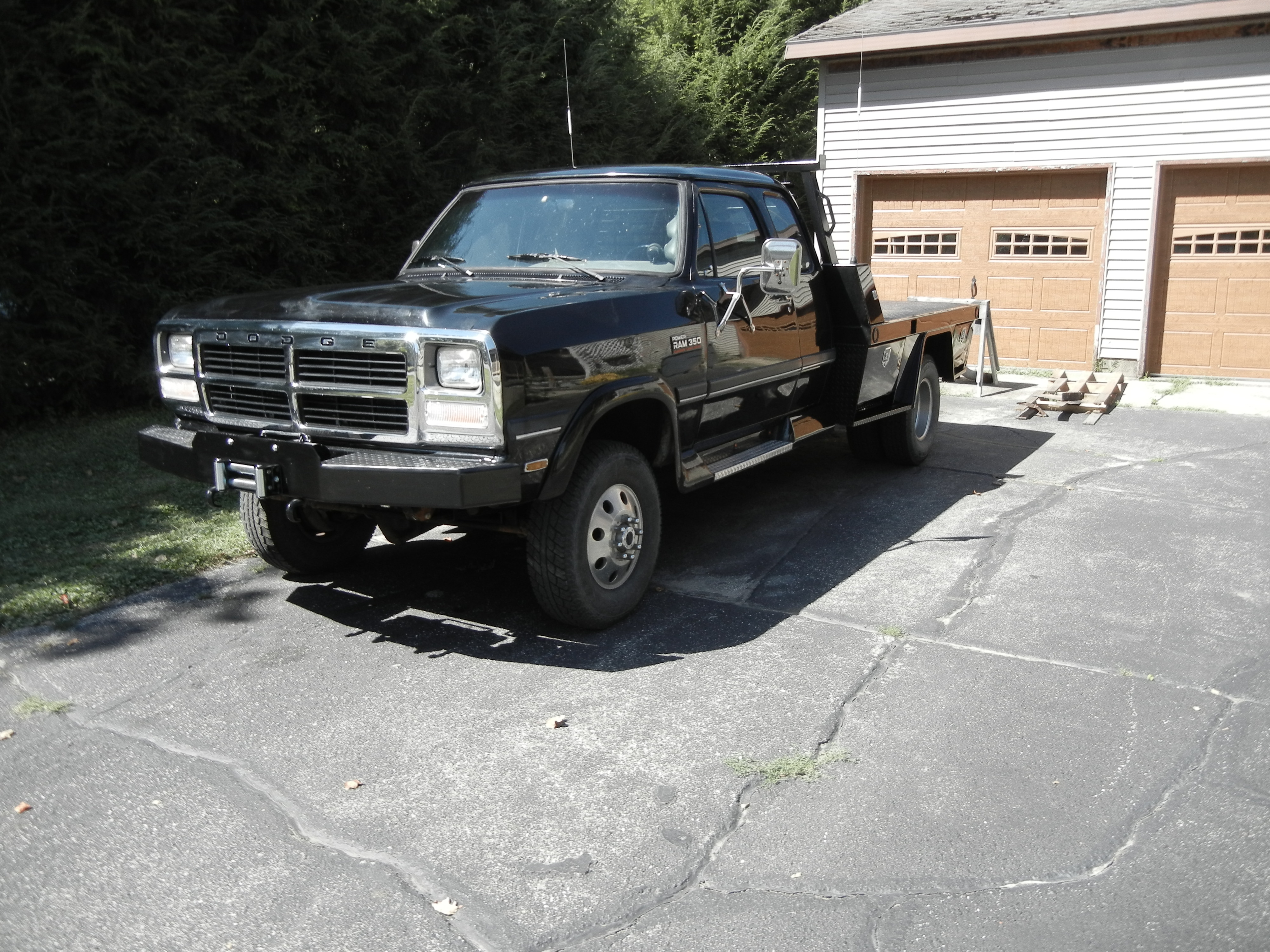

It supports my 200 lbs with no problem. Here is the installed pic.
Those steps came with a black rubber pad in the step area. You couldn't see the steps at night. So that would have lead into a scraped shin. So I put the alumin on to see the steps better at night.

looks really nice.

I agree. Slick, clean, and definitely had some thought put into the design

That's why I looked so long for a set. They blend into the flat bed real good. Before I found these I had a set of Stull Stainless tube running boards I was going to install. So those found another home real fast.
