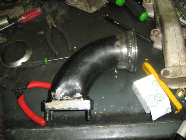

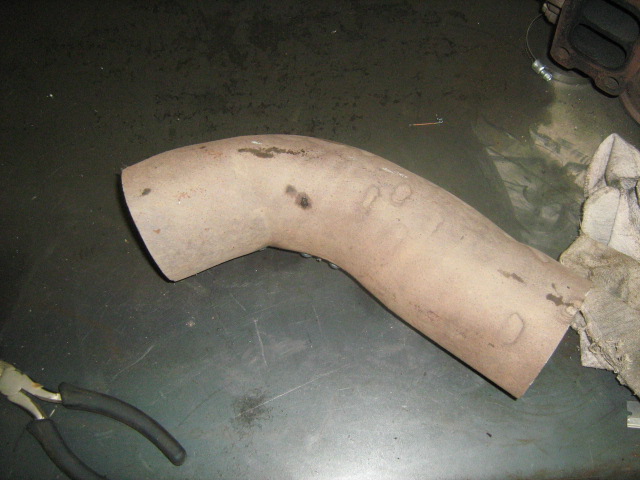

using some scrap exhaust pipe from a 7.3L Ford and some heat to make the hot pipe.
Attached Thumbnails Building twins with 3rd gen turbos-april22-025.jpg   Building twins with 3rd gen turbos-april22-026.jpg

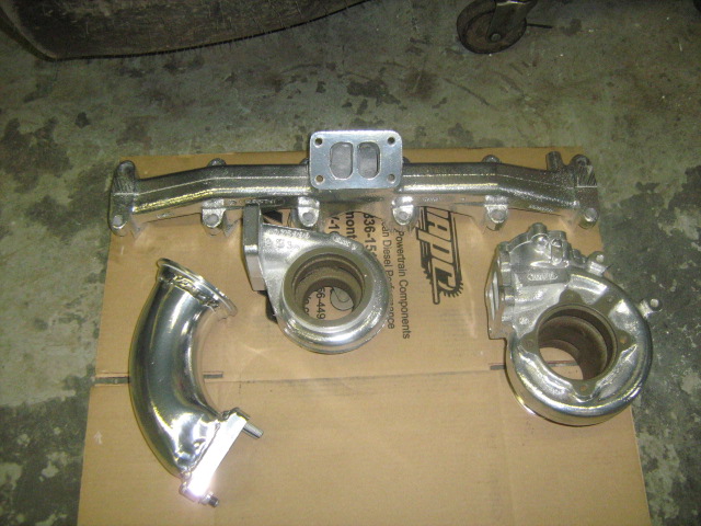

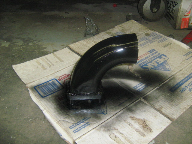

completed welding the flange on the hot pipe. I sent both exhaust housings, manifold and hot pipe out to be coated.

tig or mig welded
looks good when are mine showing up, i'll take a finished product

welded up with a mig.

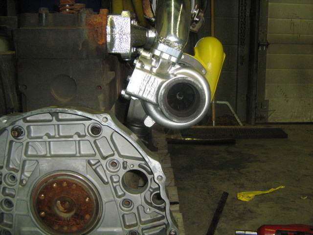

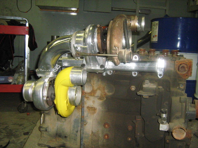

update #1

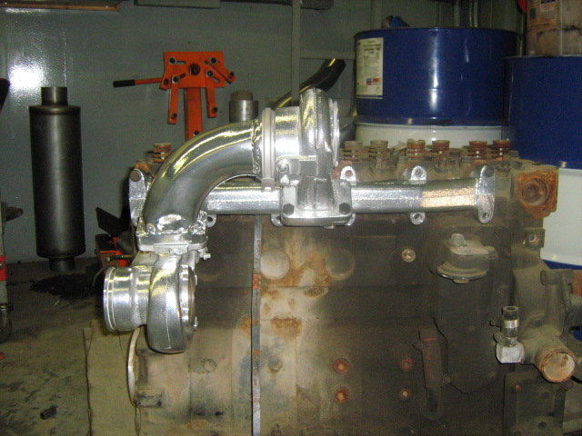

Got all the pipes back and mocked it up on a block. Hopefully it'll be in the truck by the weekend.

looks good and thats a good place for a muffler

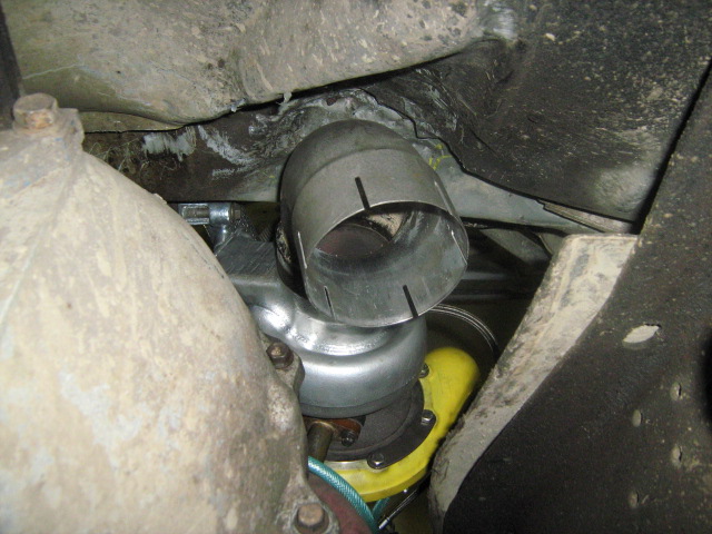

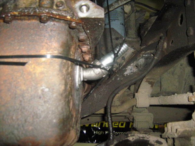

One long night and there in minus the charge pipes, but it's running with no oil leaks. Can't wait to road test with a charge pipe and see if the idea works. Ended up using a 62/80 instead for the bottom. The bung on the pan is a weld on unit for hydraulic tanks with 3/4" NPT and 7/8" hose.

Did you weld the bung in on the truck?

bung is welded on to pan. Hood closes and has clearance for when the hose swell with boost.

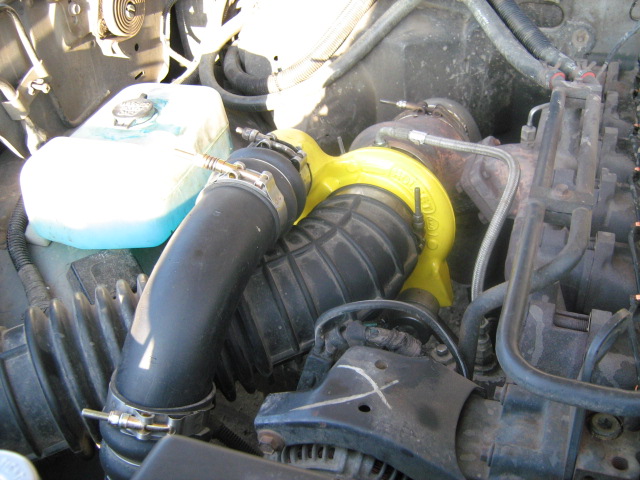

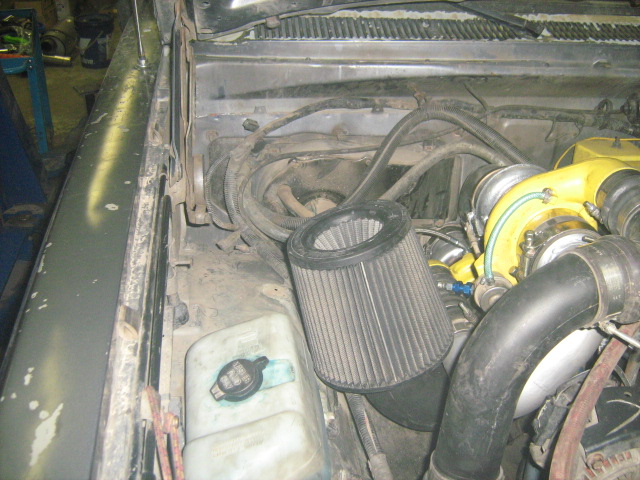

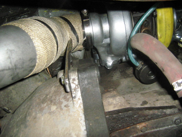

pictures of the end result.
Attached Thumbnails Building twins with 3rd gen turbos-may14-001.jpg   Building twins with 3rd gen turbos-may14-003.jpg   Building twins with 3rd gen turbos-may14-005.jpg

Looks good excellent job
