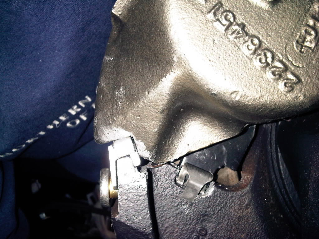

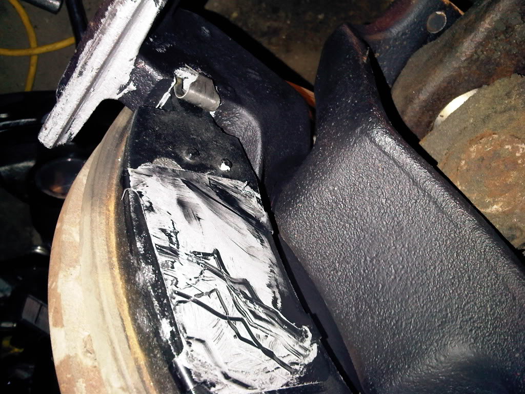

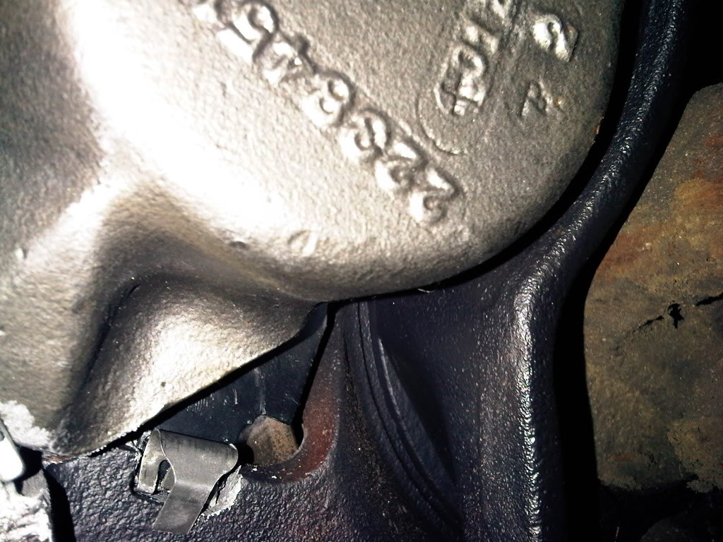

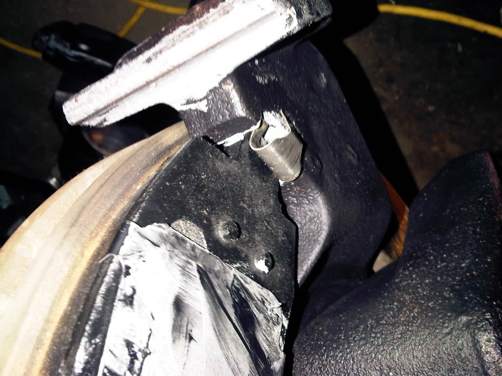

For those trying to figure out how to install the front brake pad anti rattle clips (dana 60 axle) like i was. I searched for hours and finally found one picture of the proper way to install them. Thought i would add my pics so it may help someone else out.
They go on the inboard pad at the bottom as shown.

Thank you!, they were missing on my truck and was wondering where they go also.

I have a wear tab rivetted onto my pad and I don't see it in your pics. Did yours have one and it's on the other end of your pad(into the high slot), or did yours not have them?

Yes, its on the other end (high side).
