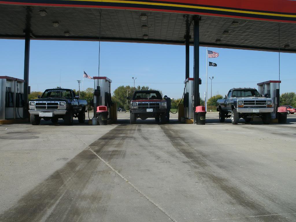

When Jon followed me I got 21 we were usually right around the 60mph mark went 525 miles on that tank,I did a little more running around when we got to SOP though. But like Jon said we were easy on the skinny pedal.This was in my 90 W250 with lot of pump adjustments a 4" lift and bad injectors I also ran the air on the way out. and was loaded about 1000 lbs heavier on the way back.
And just cause I like pics
Me on the far right Jon on the far left and Ike in the middle
