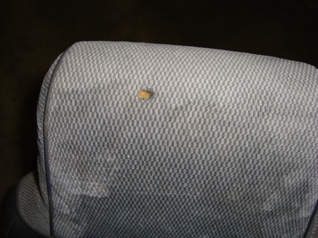

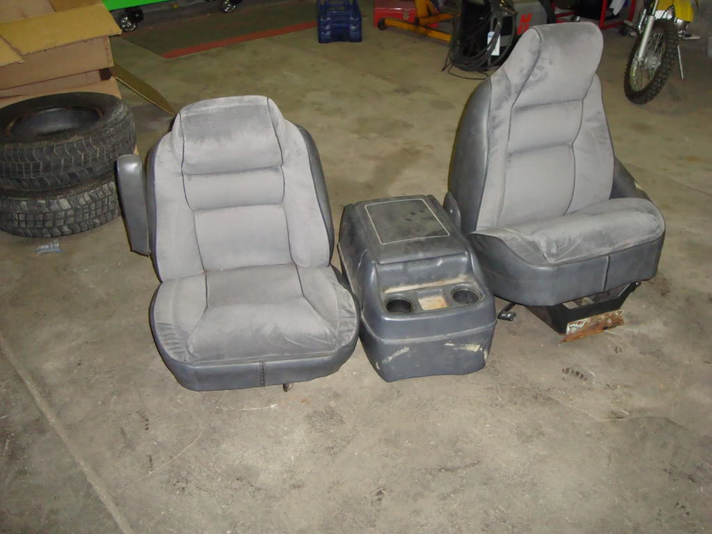

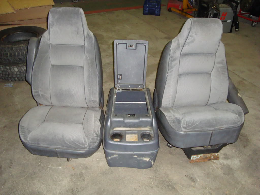

heres some pics of the seats
and thier is one ciggeret burn on the passanger head rest
