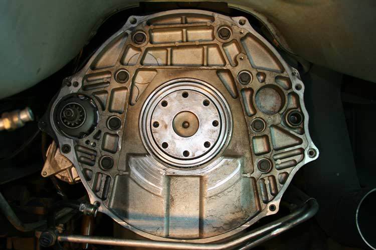

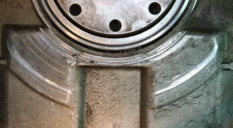

It's a common thing for our (1st Gen) flex-plates to crack around the crankshaft hub. It appears to be a 50/50 deal and isn't exclusive to bombed trucks. Dodge apparently recognized it's an issue and has superseded the 1st gen part number with the 2nd gen part number.
If you're gonna be in there, it's cheap insurance to go ahead and replace it. The worst-case scenario is a damaged/ruined engine/transmission adapter, torque converter, transmission input shaft, trans pump . . . . . ..
I was lucky years ago, with stock power, when mine let loose . . .
The replacement is basically thickererer (stock nested in a new one) ..
I've had very good results with the SunCoast unit. They're good people to deal with.
