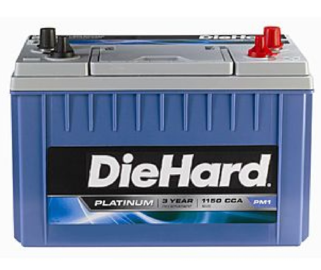

Hunter, I had some battery problems recently and went looking for a big boy to put in there. I bought one of these. They say it is a relabeled Odyssey, but I don't know or care, it is 1150 CCAs of starting power. It weighs 85 pounds. It yawns while cranking the old girl. Kind of pricey, but so far I am very happy with it...Mark
This is what I put in mine. The main attraction for me was the screw posts for axillary stuff. The capacity is great as well.
