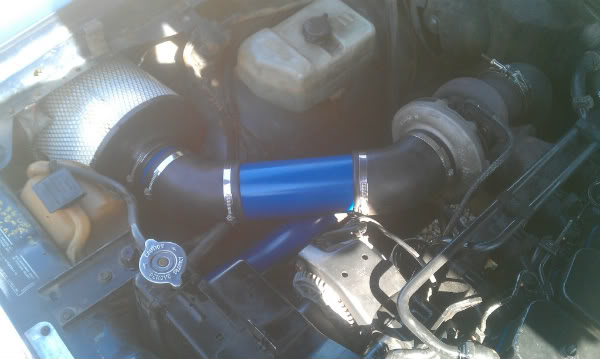

I just used this to write up to build my intake. I figured id post a picture of it aswell.

Frozenboost.com has 4.5" X 4" 45 degree boots (only blue in stock right now). H
Originally Posted by ......Falcon1 - did you manage to squeeze the 4" elbow over the 4.5" airbox tube?
[IMG
https://www.dieseltruckresource.com/pics/data/500/medium/38663Cold_air_1.jpg[/IMG]
That's what I'm wanting to do, but I thought I'd first make sure it was possible.
