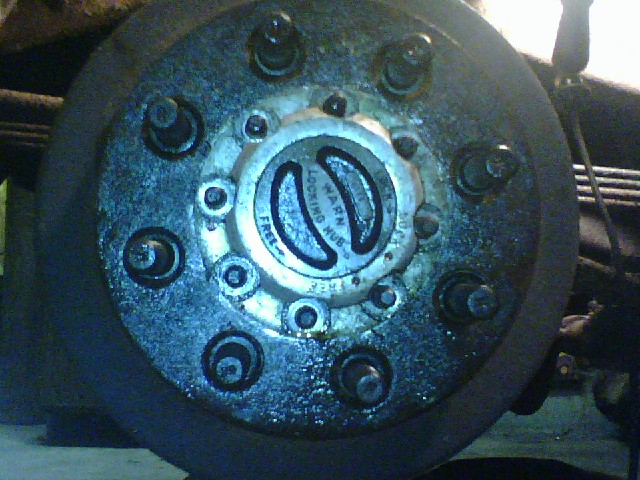

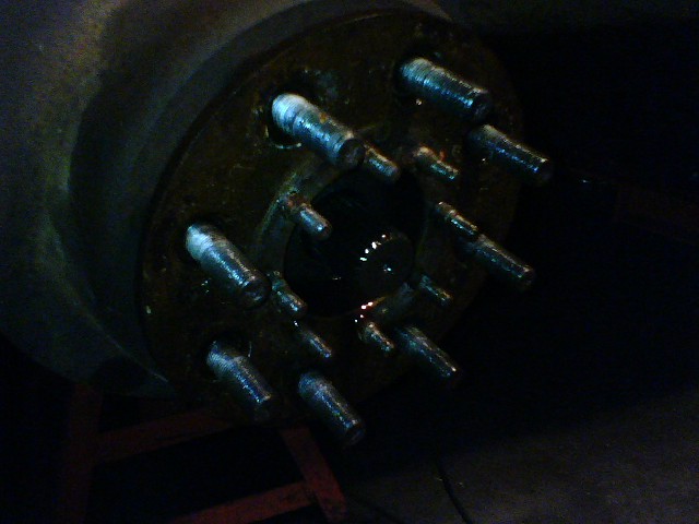

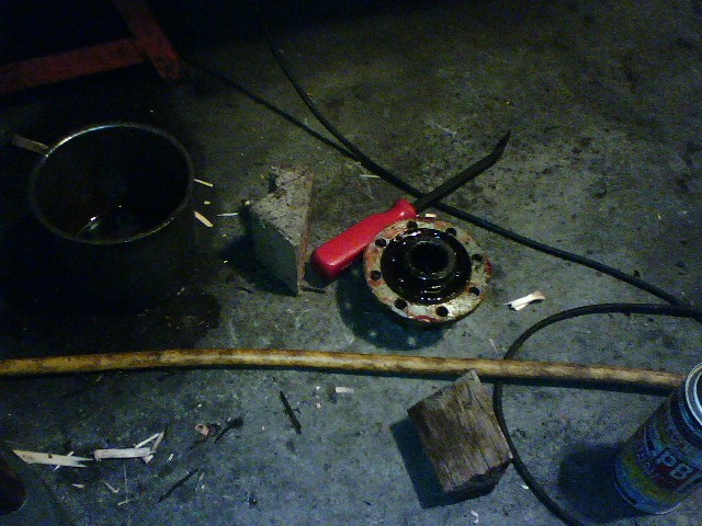

I'm working on a new to me 74 Dodge W300. It has a closed knuckle Dana 70 front axle. I'm going through everything, cleaning, draining and greasing etc.
I'm trying to remove the lockout hubs on the front axle. They are internal Warn hubs. I can't seem to get the hubs off. They are different than what we have on our 89-93 Dana 60 fronts.
Am I just not beating on the aluminum hub hard enough to separate the lockout assembly from the hub/drum assembly? I'm wanting to take things apart to clean and regrease. It has studs, I've removed the nuts and lock washers. By chance does this lockout have coned washers (wedge locks) like the rear axle shaft has? Any help is appreciated, thanks.

Seems like the front axle on my military Jeep has a similar setup and, IIRC, a good healthy whack with a plastic mallet did the job.

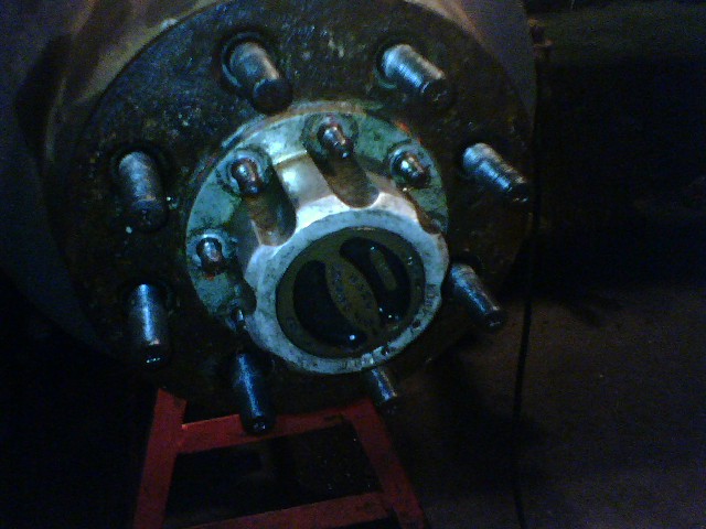

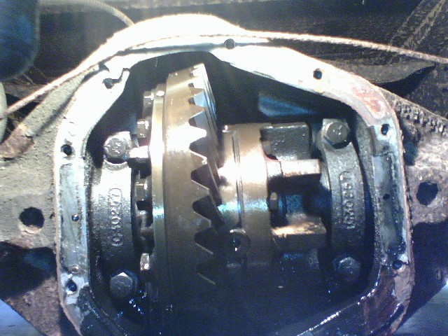

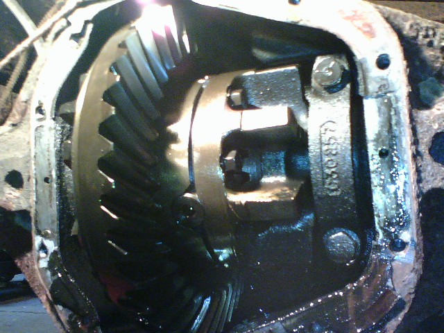

Yep it's a D70F closed knuckle. That would really be a score if it was an open knuckle 70F. Here's another pic. Also is a pic of the rear D70. The front looks the same. I've never seen a two piece open differential. As far as I can tell, it's not a locker or LSD, no clutches or springs etc. With both wheels off the ground, I turn one tire one way, the other goes the opposite direction. Sure sign of an open diff right?

Yup! And looks nothing like my Power-Lok D70 rear.

Maybe it is like a "gov lock" where there has to be a difference in wheel speed from one side to the other before it locks?

Well it's closed back up now and filled with oil. I have a 70 2-U (35 spline) with a Detroit Locker and 3.54's. I'd like to know if that Detroit would work with the 4.88's in this 70-B rear.

A dana 70 closed knuckle front diff has the same size drive axle u-joints as a dana 44.Other than the size of ring and pinion they are nothing special.Now a open knuckle dana 70 is the one you would want but extremely rare to find they were only used under special build conversions as far as i have been able to find out.If your going to use the truck hard in 4x4 than your better off finding a dana60 lotsa after market stuff for them.As for the centre carrier most all dana 70s and 80s open diffs have that style.Whats good about them is you can buy all kinds of lockers to fit inside that carrier.

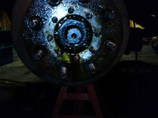

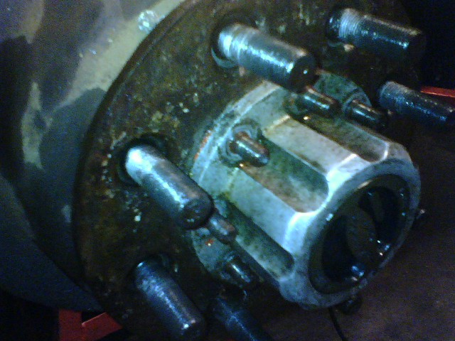

BTW, here's a couple more pics, I finally got it off. I just wasn't beating on it hard enough, as usual. Not having a large rubber mallet or dead blow hammer, a friend of mine gave me the idea of a block of wood and regular steel hammer. Can't believe I didn't think of that before.
