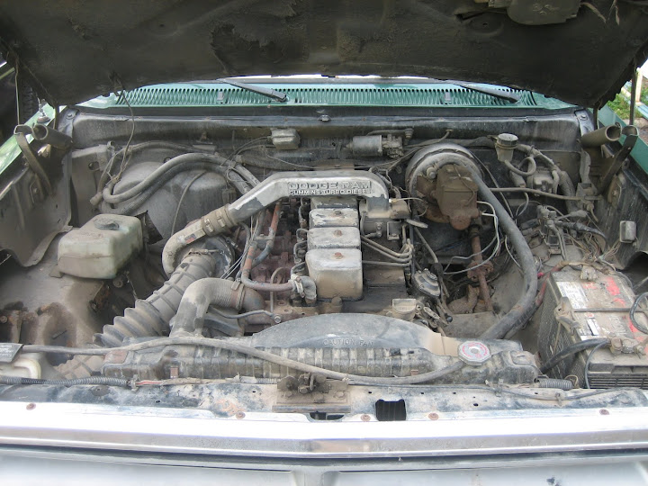

The bad thing is I cannot find that it has an external regulator. I have looked all over the firewall and both fender wells and do not see anything that looks like a regulator. They say it is on the firewall towards the middle but I do not see one. I really do appreciate all of the help.

On my 91.5 it's the silver box above the valve covers and to the pass side a bit:
Actually...it's at the same spot on this 89:

I don't have anything up there. I have learned that eventhough mine says 91 in the door it is considered a 92.
