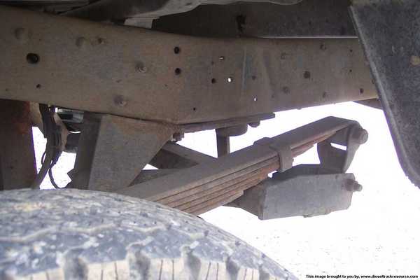

Here's a question for you. Does the system pivot towards the rear or does it pivot towards the front. What I mean is where is the point where the frame work bolted to the frame. Bob and I both have the Kelderman set up but his pivots in the rear and mine pivots in the front. That will make a big difference in weather or not you will have clearance issues.
FRONT PIVOT:
