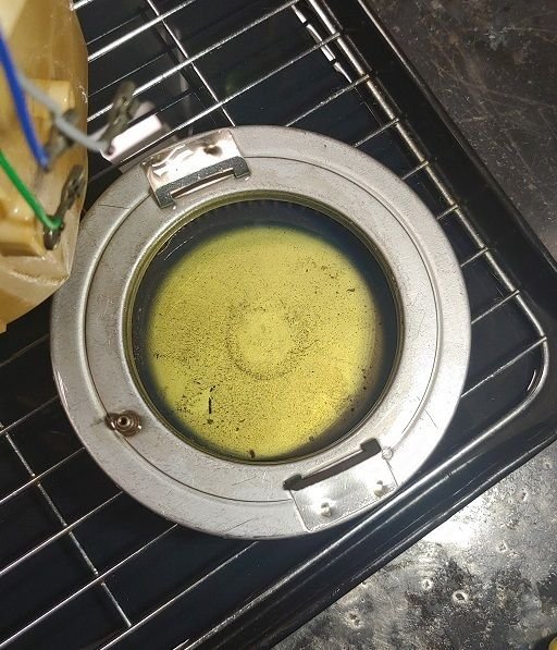

Old Oct 22, 2022 | 11:36 AM
  #43
Hey Folks
Hey Edwin Smith, since this pertains to you and your rig too.
I think I finally got a hold on the air infiltration issue that's plagued me for so long. Keeping the fuel tank full was a bit of a bandaid approach, so I decided to delve deeper.
The only time this truck broke down (the several dozen times over the last decade), was when the fuel tank was 1/2 tank or less. That got me thinking again on what I should do to fix it. I do believe I was on the right track all along, but since I did the most recent repair, it's been good even letting the fuel level drop to "E". Granted there's still 6 or 7 gallons left at "E", but it still would have left me stranded on the side of the road in most cases.
So I took the reservoir out and inspected it. The fuel reservoir metal assembly bracket was cracked, but that's not related to this. Luckily, I had an extra reservoir from Ollie, and was able to combine the two reservoirs into one.
If you look at the attached photos, you will see what O rings that went bad in the pickup tube from the reservoir bottom. They were both shot after 30 years submersed in fuel Mushy and did not have a tight seal on the brass pickup tube in the reservior head.
You should take photos of every step, as this system is oriented in a specific manner, and you can easily disassemble and reassemble without putting it back together in the same clocked orientation. If you do, the tube will not meet the reservior head and brass pickup tube in the correct spot.
Time will tell, but I'm really sure that these two soft rings were shot, as when I put the new rings in the pickup tube, and assembled it, it was tight, vs the old which was loose and wobbly.
I would NEVER buy another one of these reservior fuel filters that mount to the bottom of the reservoir. I put my original red bucket screen back on there, as this piece of garbage fuel filter allowed all the junk to bypass it.
Bed cutout
Removed from truck tank
Broken metal hanger on reservoir
Brass pickup tube and connector
O rings inside pickup tube
Orings removed
Clogged return fuel screen
Cleaned screen
STOCK SUCK *** FILTER was FULL OF DEBRIS
