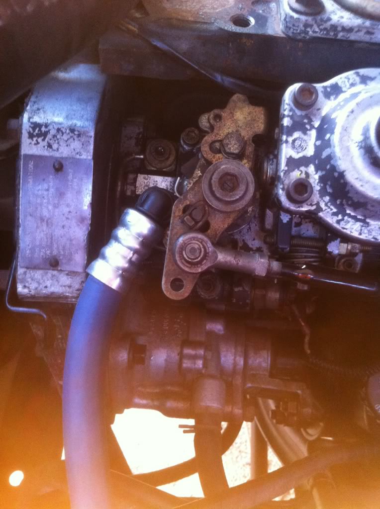

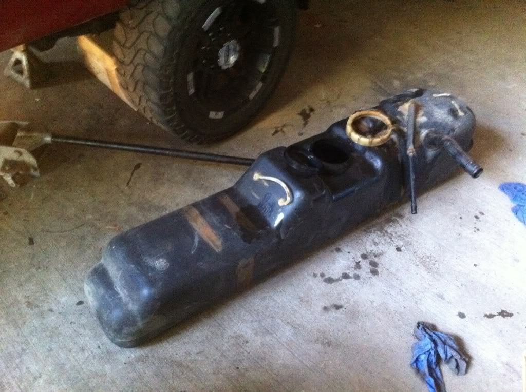

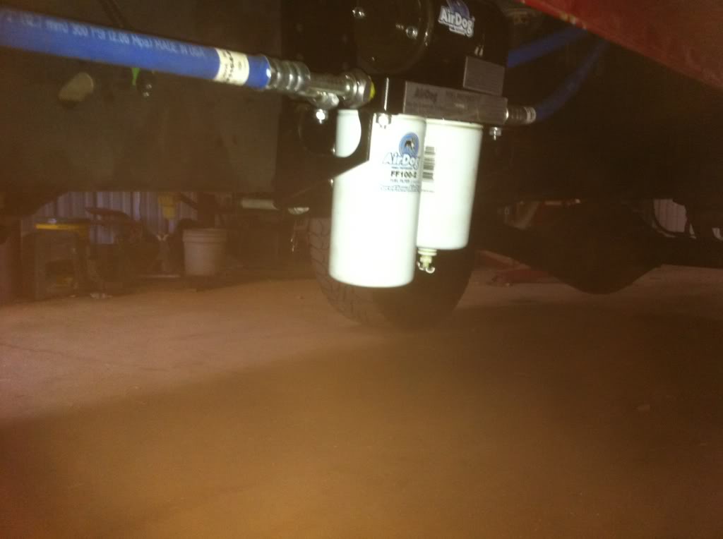

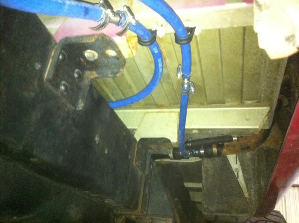

Probly not too helpful but only ones I took..
I had to throw one in with my new tires on! Mine hangs a little lower than most but that's where I decided to mount it because of my tranny cooler. It's pretty straight forward install and I even left stock return line from motor.

Oh ya runs like a top. I still have stock injectors and before the airdog the turbo would clean up all the smoke but after the Airdog there is a light haze. Seems to run a lil smoother and I don't have to really worry about bad diesel as much. Only disadvantage I see is it is electrical and relies on your battery and alternator.
