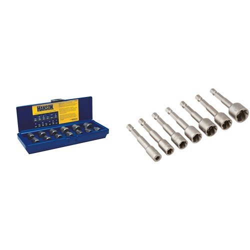

Those Irwin brand nut driver easy outs have never let me down. Have you tried those?

What style of Irwin easy outs Augie, Can you post a pic?

These nut driver type, TCows. Most auto parts stores carry them. To the left of the nut driver type are the socket type, which work well also.
If yours is a sheared off stud within a threaded port, then these won’t work
