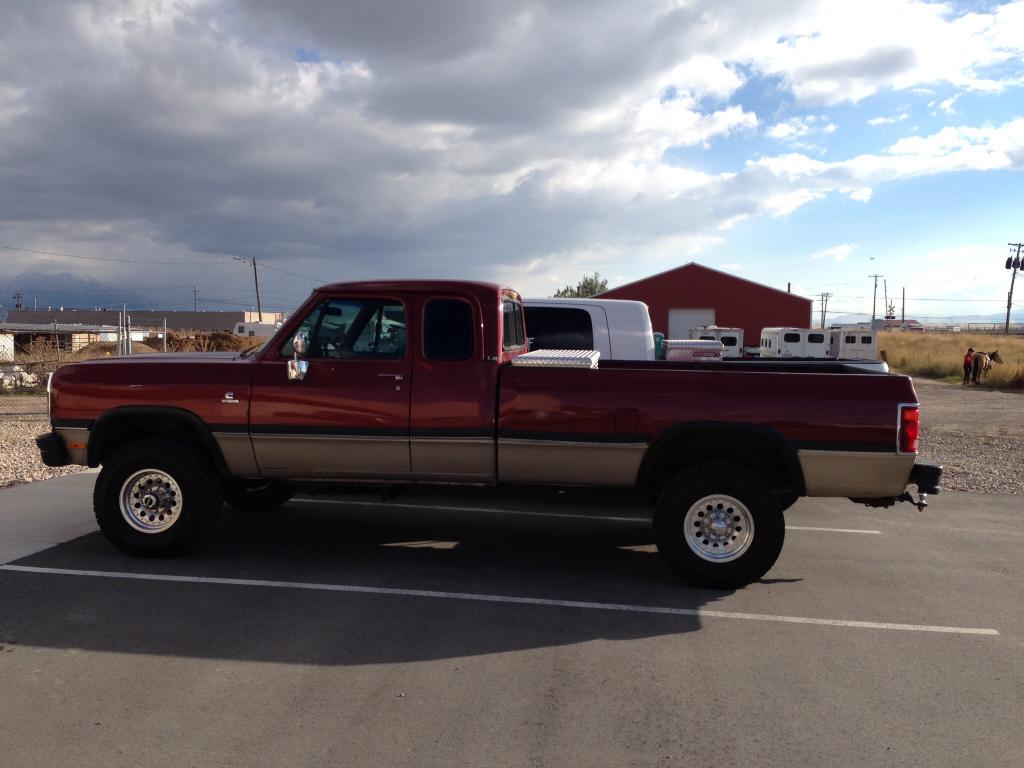

I've had my 92 W250 for over a year now, and it's always fired right up. I was at a drive through the other day and killed it so that they could hear me. When I went to start it up, it just cranked and cranked. I pushed it through the drive through with a couple of skinny hipster kids and had it towed home. I've replaced the fuel filter and the lift pump. Still won't start. Now I'm getting fuel shooting out between the filter and the fuel heater too. Does anyone know what I might be able to do to get my baby running again? I'm about to head to NAPA to grab a fuel shut off solenoid. I don't have any idea how to stop the leak. Please help! Thanks
