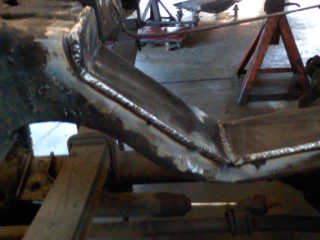

Did you have to Mod the cross member under the oil pan to get it to fit? I have a 77 Crew and I am tired of feeding the 460. My measurements show that I have less than 0.5 inch clearance and still be able to shut the hood over a cummins. That does not leave much room for flexing. I am looking at a 93 doner.

I have a 79 F250 with a ctd. Had to cut and replate cross member. Took out about 1 1/2". I narrowed the dodge engine mount cross member, weled plated on the ends and bolted it to my frame. That way I could the stock motor mounts.

better picture
