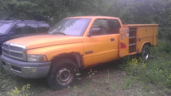

I picked up this hideous thing right around the corner from my house to supply the engine:
It's a 97 with 243k miles. I bought it very right and can hopefully get a good amount of my money back out of the bed, good doors, and scrapping the rest. For the engine, I will most likely go through it lightly, fix any oil leaks, swap injectors, KDP it, and make it pretty. I might go so far as to pull the head and have it rebuilt, but with the decent miles, I'll be leaving the shortblock alone. Power wise, I'll prob shoot for bumping it up to 250-300 HP and somewhere around 600ft lbs. Enough to to go but still be mostly normal.

If it's a 97 auto it will have a 180 pump on it. If stick it'll have the 215.
If it's a 180 this is what I would do to the motor. 2095 rack plug. Remove the plate. Do the afc mods and tune up the afc all nice. Even without a plate you should be able to tune it to almost zero smoke. I would pick up a set of 215 injectors (5x10s),have them cleaned and repopped. Buy a tork tek ofv valve and 3k gsk springs. Set timing at 16*
Whatever you do, remove the head and have it gone over. Take it off, have it cleaned and checked for cracks, have the valves cut and deck the head, make sure it's good to go another 250k miles. Put new valve stem seals in with 60# valve springs. . Get new oe head bolts. Stock Cummins head gasket.
For the rest of the motor just clean it up and do a general reseal. You know. Front/rear crank seals. Pan, oil cooler if it's seeping. Tappet cover. Tab the kdp. I would retorque and locktite most bolts as well. Most of the time things start leaking in the first place because the rattling motor loosens the bolts.
Do all that and come back and tell me I was right.
While it's all off, now would be a good time to upgrade to an he351cw as well. It's a great turbo for the kind of power you'd be making.
Also, if you do everything I said you'll have 300-350hp and 700+ft lbs and the motor should still be plenty reliable. Just get a clutch to match.

It's a 180hp auto. I decided today that I'm going to pull the head after I noticed a little bit of compression escaping around a head bolt. I will be doing the rebuild on the head myself, I have a full valve and seat grinding setup. I can definitely budget going through it as I only spent $1500 on the entire truck.
