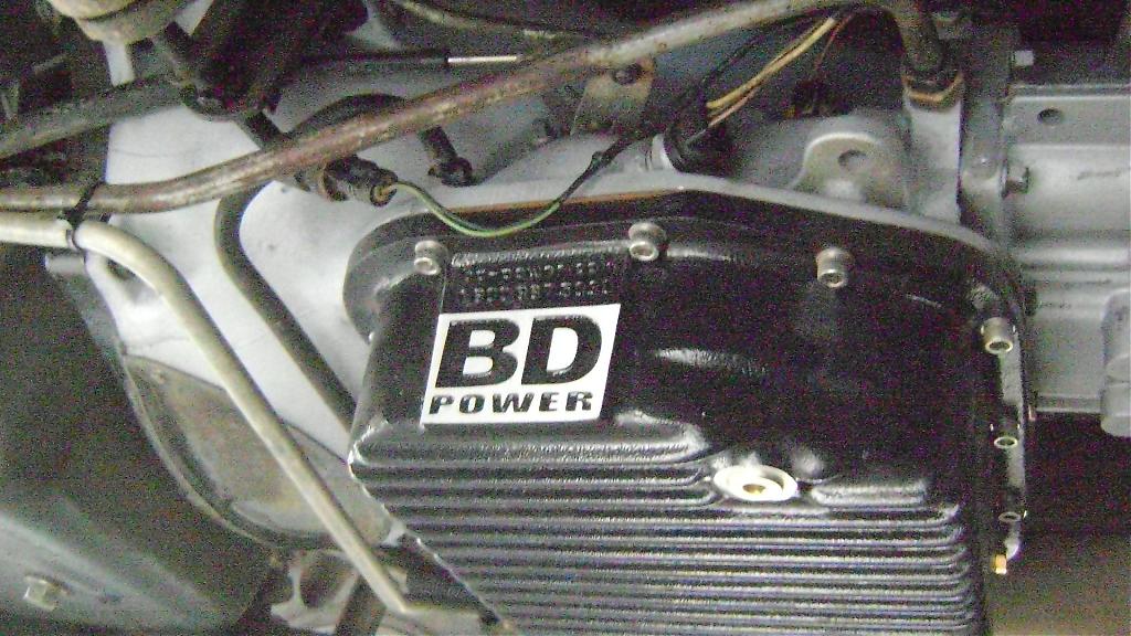

Here's a pic of my new transmission...wanted to get a quick one up before she gets dirty! Enjoy....sorry if its not too good. Towed a 16' flatbed loaded down with a bunch fencing this weekend, and it was in the mountains....ran great. The Denny T II and the 3200 spring are workin' wonders. Gotta get some gauges next. Puttin a cold air on this weekend, so she's comin' along. Thanks again for all the help and advice.

Looks nice glad to hear it is working well for you.

If you don't mind what did it set ya back $. and what all did you replace/upgrade.

Well, for the full meal deal, it was about $2800.00...that was with a new heavy duty torque converter, shift kit, potentiometer, new valve body, new transmission casing, new cooler lines, and to top it off a BD sump pan...that's cost of parts, labor, etc...not cheap, but I wanted it done right.

Do you know what clutches and other hard parts he used?

I used Borg-Warner clutches....hopefully I spelled that right....the torque converter is from High Torque here in Idaho....he also put a new transmission case on cause the one I had a heal coil in her the size od a dime...never could get it to seal up. So now that's fixed. No leaks at all. Any Treasure Valley Idaho guys looking for tranny work, see Darren at General Transmission in Nampa...great guy to work with. Truck is running awesome.
