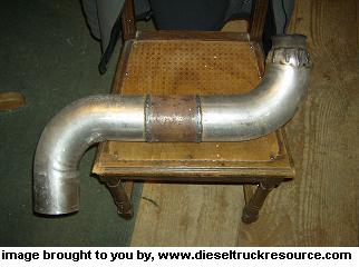

Heres the pics
I hope i didnt screw up how the page loads. Sorry i am newbie at pic posting

That might be ture but biggers is always better77machomopar how far is it from the flang to the down side of the downpipe?

'lil bigger Looks cool, I'm gonna go do mine

Measurements
I will measure it tonight. I just used 4" 90 degree angles with 6" legs. the leg that is welded to the flange was cut shorter so it wouldnt hit the trans, firewall, etc. The pipe is the same overall length of the stock pipe.
