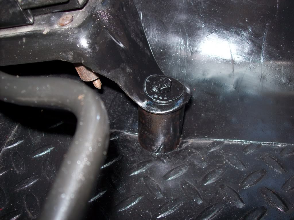

Front mounting bracket. I got a piece of 1 1/2 .095 round tubing and cut 4 2" spacers in which i bent the origional brackets on the 3rd gen seats to a 90 degree angle so the spacers would fit flat against the bracket and the floor, i then put a 4" long 5/16 bolt through the floor with big fender washers on each side. there are 4 brackets on the front you have to do that to,

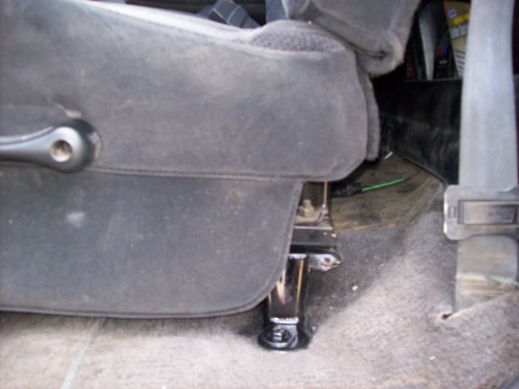

For the rear mounting brackets i cut all the 3rd gen ones off and used the two outer ones that i cut out of the 4 and welded them onto the side of the bracket on the seat frame in which i then bolted through the floor with 1 1/4 5/16 bolts with fender washers on each side, you don't need spacers on the rear, I only used two mounting spots in the rear cause the center section of the seats is on the tranny hump, The seats have a total of 6 mounting spots four in front two in rear,

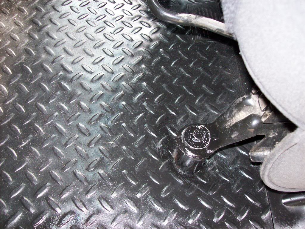

Here is a pic of the front middle mounting brackets,
