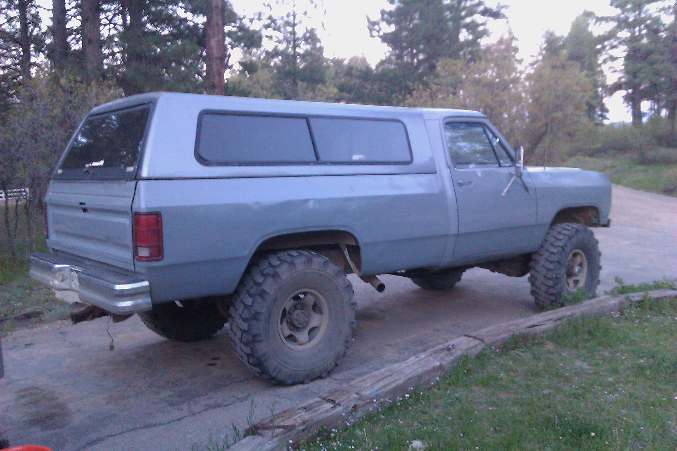

I run a set of the 325 XML's on my truck. I got 3 years out of them. They where a decent tire for the surplus price. They DO NOT like high speeds. The tread really starts wearing off if you drive above 65mph. They are also VERY heavy at about 115lbs per tire.
I also did a LOT of fender modifications to run 38-39" tires with only front leveling springs. I absolutely love the ability to run the large tires with basically no lift. Its easier to get in and out of. Its easier to park and drive in town. Mileage stayed pretty decent. Loading things in the bed is easy. Off-road the tires really help with the 7K weight of the truck. Aired down it floats in the soft stuff and the larger tires provide enough clearance under the rear diff to your not always dragging it.
If I was going to do it again I would do a set of Trailer products front fiberglass front fenders with some custom aluminum inner fenders. Then find a dually bed in the rear and remove the dually fenders....basically an instant HUGE wheel opening for a SRW truck. It even matches the front fiberglass fender pretty well.
