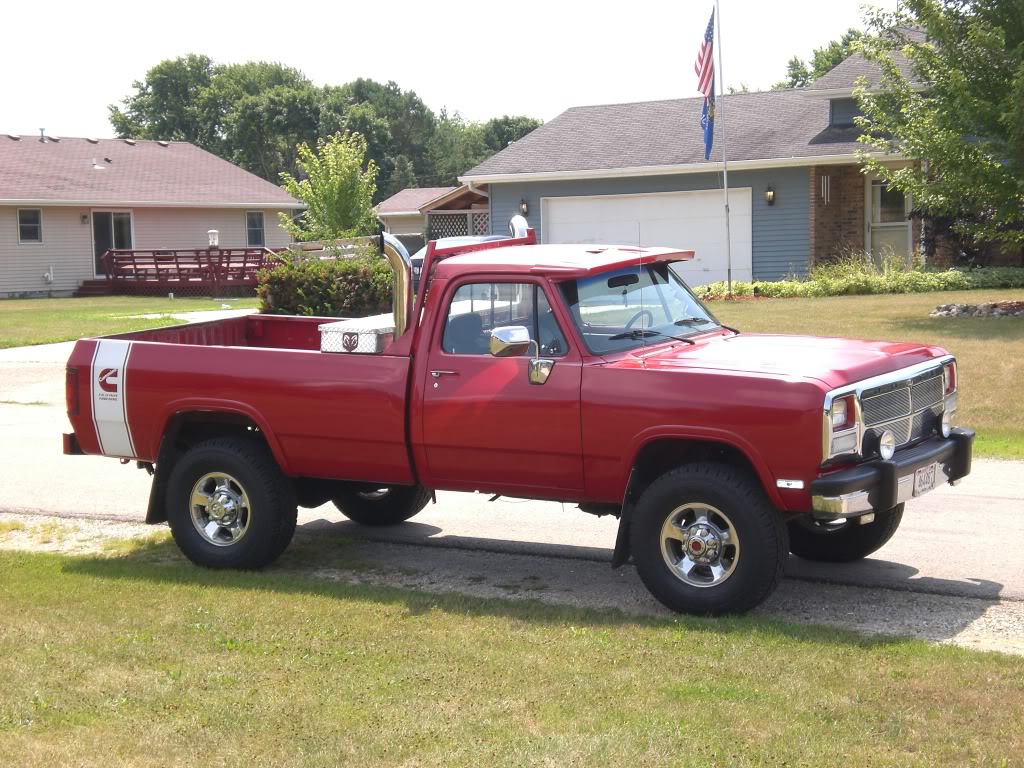

Old Aug 27, 2009 | 04:08 PM
schamran's Avatar
Posts: 2,081
From: Wisconsin
They look sweet but they do take away from my acceleration. I am also looking to re-gear. I put my hx-35 on with my old tires, and drove it a few times. it was quite a while before i drove it between then and when i put the 35's on, but it seems like they take a lot of power. I am probably geared better for the freeway now though. I would like to figure out exactly what gear set would put me back to where I was with stock 31.5" tires. I don't want to go back to those tires though.
